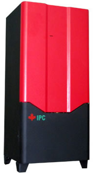

²úÆ·Ãû³Æ£º PFEµçÌÝרÓýÚÄÜ×°ÖÃ
ÐÍ ºÅ£º PFE
µÚ6´úIPC PFEµçÌÝרÓýÚÄÜ×°ÖÃ
IPC PFEϵÁеçÌÝ»ØÀ¡Öƶ¯µ¥Ôª£¬ÊDzÉÓüÓÄôó¼¼ÊõÉú²úÖÆÔìµÄµçÌÝרÓøßÐÔÄÜ»ØÀ¡Ê½Öƶ¯µ¥Ôª¡£Éý½µµçÌÝÔÚʹÓõçÌÝ»ØÀ¡½ÚÄܲúÆ·ºó£¬ÄÜÓÐЧµÄ½«µçÈÝÖд¢´æµÄÖ±Á÷µçÄÜת»»³É½»Á÷µçÄÜ»ØË͵½µçÍø¡£½ÚµçÂÊ´ï25£¥- 45£¥¡£´ËÍ⣬ÓÉÓÚÎÞµç×è·¢ÈÈÔª¼þ£¬½µµÍÁË»ú·¿µÄ»·¾³Î¶ȣ¬Í¬Ê±Ò²¸ÄÉÆÁ˵çÌÝ¿ØÖÆÏµÍ³µÄÔËÐÐζȣ¬Ê¹¿ØÖÆÏµÍ³²»ÔÙËÀ»ú£¬ÑÓ³¤µçÌÝʹÓÃÊÙÃü¡£»ú·¿¿ÉÒÔ²»ÔÙʹÓÿյ÷µÈÉ¢ÈÈÉ豸£¬¿ÉÒÔ½ÚÊ¡»ú·¿¿Õµ÷ºÍÉ¢ÈÈÉ豸µÄºÄµçÁ¿£¬½ÚÄÜ»·±££¬Ê¹µçÌݸüÊ¡µç¡£ÔÚÐí¶à³¡ºÏ£¬½ÚÔ¼¿Õµ÷ºÄµçÁ¿ÍùÍù´øÀ´¸ü´óµÄ½ÚµçЧ¹û£¬ÊÇеçÌÝÅäÌס¢¾ÉµçÌݸÄÔìµÄÊ×Ñ¡²úÆ·¡£
IPC PFEϵÁеçÌÝ»ØÀ¡Öƶ¯µ¥ÔªÒÑͨ¹ý¹ú¼ÒµçÌÝÖÊÁ¿¼à¶½¼ìÑéÖÐÐĵIJúÆ·ÐÔÄܼì²â¡¢±±¾©½ÚÄÜ»·±£ÖÐÐĵĽÚÄܲâÊÔÒÔ¼°ÉîÛÚµç×Ó²úÆ·ÖÊÁ¿¼ì²âÖÐÐĵݲȫ¼ì²â¡£Ëù¼ì²âÏîĿȫ²¿ºÏ¸ñ¡£
¸ÃϵÁвúÆ·ÊÊÓÃÓÚËùÓеçÌÝ±äÆµÆ÷£¬Çҹ㷺³É¹¦Ó¦ÓÃÓÚÈýÁâ¡¢¸»Ê¿¡¢ÈÕÁ¢¡¢°ÂµÄ˹¡¢µÙÉ­¡¢Í¨Á¦¡¢ÓÀ´ó¡¢ÓÅÁ¦Î¬ÌØ¡¢ÈýÈÙ¡¢µÂÊ¥Ã×¸ßµÈÆ·ÅƵçÌÝ¡£
IPC PFEϵÁлØÀ¡×°ÖõÄÌØµã£º
£¨1£©Ð³²¨2%£¬±ÈÉÏÒ»´ú²úÆ·½µµÍÁË50%£»
£¨2£©¸ÉÈűÈÉÏÒ»´ú²úÆ·½µµÍ90%£»
£¨3£©ÔëÒô±ÈÉÏÒ»´ú²úÆ·½µµÍ20%£»
£¨4£©¹ýÈȹÊÕϱ£»¤¹¦ÄÜ£»
