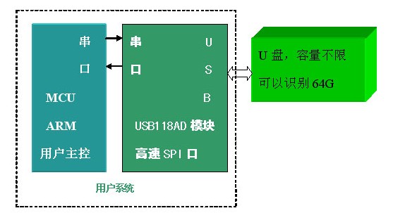

USB118ADÄ£¿é×÷ΪǶÈëʽµÄUSBÖ÷»ú¿ØÖÆÆ÷£¬¹¦ÄÜÄ£¿é¿òͼÈçͼËùʾ¡£
    Ö»Òª½«USB118ADÄ£¿éǶÈëµ½Óû§ÏµÍ³ÖУ¬ÓÃϵͳµÄÖ÷¿Øµ¥Æ¬»ú´®¿Ú»òÕßSPI¿ÚÓëUSB118ADÄ£¿éµÄͨÐŽӿÚÁ¬½Ó£¬½«Íâ½ÓUÅ̵ÄUSB²å×ùÒýµ½É豸¿ÇÌåÉÏ£¬Óû§¾Í¿ÉÒԷdz£·½±ãµÄͨ¹ýÆÕͨUÅÌʵÏÖÒÇÆ÷»òÉ豸Êý¾ÝµÄº£Á¿´æ´¢¡£
