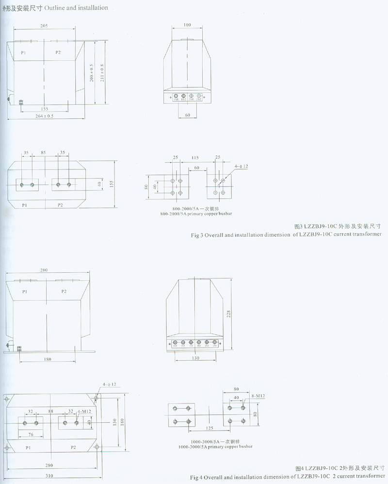

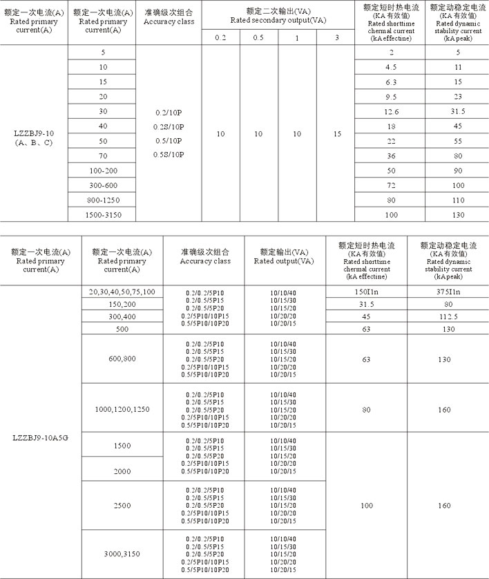

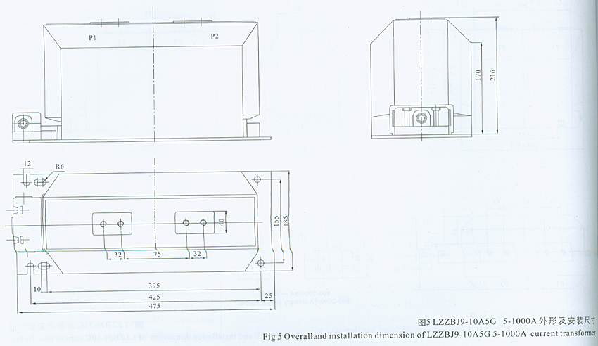

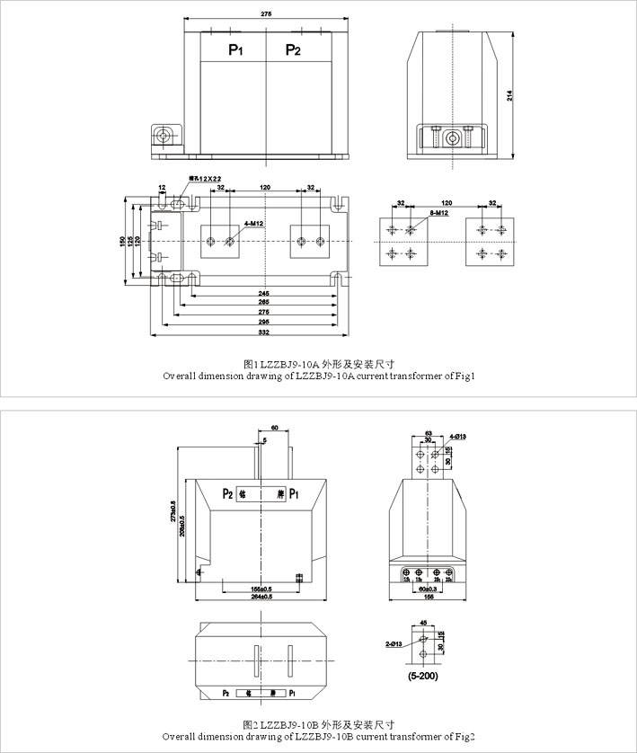

²úÆ·ÏêϸÐÅÏ¢£º
¼¼Êõ²ÎÊý
²úÆ·ÐÔÄÜ·ûºÏIEC±ê×¼ºÍGB1208-1997¡¶µçÁ÷»¥¸ÐÆ÷¡·
¶î¶¨¾øÔµË®Æ½: 12/42/75kV
¸ººÉ¹¦ÂÊÒòÊý: cos¦Õ=0.8(ÖͺóLag)
¶î¶¨ÆµÂÊ: 50Hz
¶î¶¨¶þ´ÎµçÁ÷ :5A
¾Ö²¿·Åµçˮƽ: ·ûºÏGB5583-85±ê×¼£¬Æä¾Ö²¿·Åµç²»´óÓÚ20PC.
ÍâÐμ°°²×°³ß´ç
