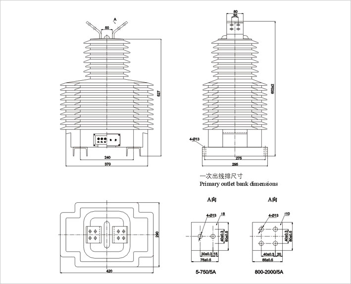

²úÆ·Ãû³Æ£º LZZBJ71-35W»§ÍâµçÁ÷»¥¸ÐÆ÷
ÐÍ ºÅ£º LZZBJ71-35W
²úÆ·ÐͺÅ
×°ÏäÊý
¼Û¸ñ
LZZBJW71-35Q»§ÍâµçÁ÷»¥¸ÐÆ÷ 1 µçѯ
LZZBJ71-35W 5-1000/5»§ÍâµçÁ÷»¥¸ÐÆ÷ 1 µçѯ
²úÆ·ÏêϸÐÅÏ¢£º

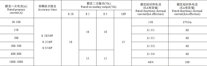

 ¼¼Êõ²ÎÊý
¶î¶¨¾øÔµË®Æ½: 40.5/85/185kV
¸ººÉ¹¦ÂÊÒòÊý : cos¦Õ=0.8(ÖͺóLag)
¶î¶¨¶þ´ÎµçÁ÷ : 5A»ò1A
»·¾³Î¶Ƞ: -45¡æ~+45¡æ
º£°Î¸ß¶È²»³¬¹ý : 3000m
ÎÛ»àµÈ¼¶ : ¢ó¼¶ Polluted grad: ¢ó
 ÍâÐμ°°²×°³ß´ç
