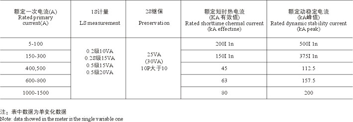

 ¼¼Êõ²ÎÊý
²úÆ·ÐÔÄÜ·ûºÏIEC±ê×¼ºÍGB1208-1997¡¶µçÁ÷»¥¸ÐÆ÷¡·
¶î¶¨¾øÔµË®Æ½ : 12/42/75kV
¶î¶¨ÆµÂÊ : 50Hz
¶î¶¨¶þ´ÎµçÁ÷ : 5A
ʹÓÃÌõ¼þ£º»§Í⣻º£°Î3000mÒÔÄÚ£»ÎÛ»àµÈ¼¶IV¼¶£¬ÅÀµç¾àÀë380mm
»·¾³Î¶Ƞ: -45¡æ~+65¡æ
 Ö÷Òª¼¼Êõ²ÎÊý¼û±í

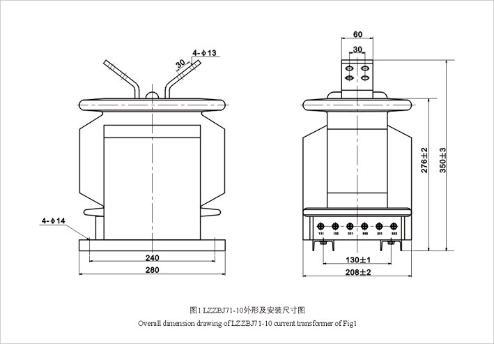

 ÍâÐμ°°²×°³ß´ç
