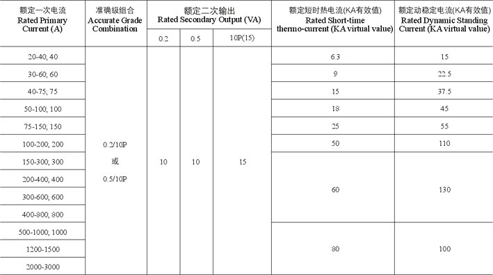

 ¼¼Êõ²ÎÊý
1¡¢²úÆ·ÐÔÄÜ·ûºÏIEC±ê×¼ºÍGB1208-1997¡¶µçÁ÷»¥¸ÐÆ÷¡·
2¡¢¶î¶¨¾øÔµË®Æ½£º12/42/75kv
3¡¢¸ººÉ¹¦ÂÊÒòÊý£ºCOS¦Õ=0.8(Öͺó)
4¡¢¶î¶¨ÆµÂÊ£º50Hz
5¡¢¶î¶¨¶þ´ÎµçÁ÷£º5A(2A¡¢1A)
6¡¢¿É×ö³É¸÷ÖÖ¸´±ä±È½á¹¹
7¡¢ÆäÖ÷Òª¼¼Êõ²ÎÊý¼û±í1

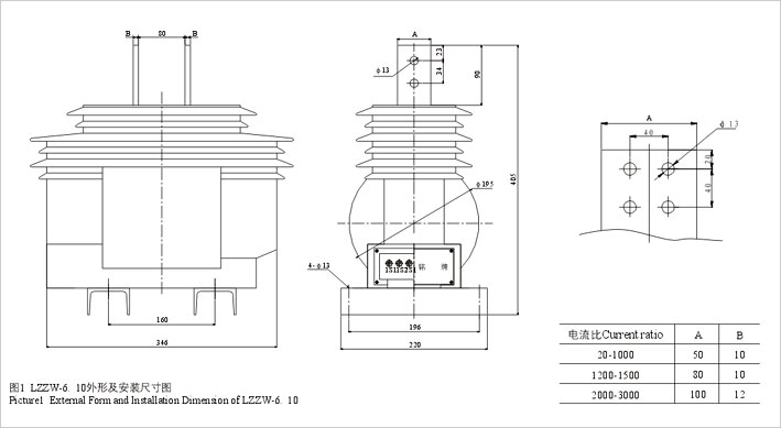

 ÍâÐμ°°²×°³ß´ç
