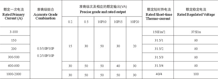

²úÆ·ÐÔÄÜ·ûºÏIEC±ê×¼ºÍGB1208-1997¡¶µçÁ÷»¥¸ÐÆ÷¡·
¶î¶¨¾øÔµË®Æ½£º40.5/85/185KV
¸ººÉ¹¦ÂÊÒòÊý£ºCOS¦Õ=0.8(Öͺó)
¶î¶¨ÆµÂÊ£º50Hz
¶î¶¨¶þ´ÎµçÁ÷£º5A(2A,1A)
׼ȷ¼¶´Î×éºÏ£º0.2/10P/10P£» 0.5/10P/10P
ÆäÖ÷Òª¼¼Êõ²ÎÊý¼û±í1

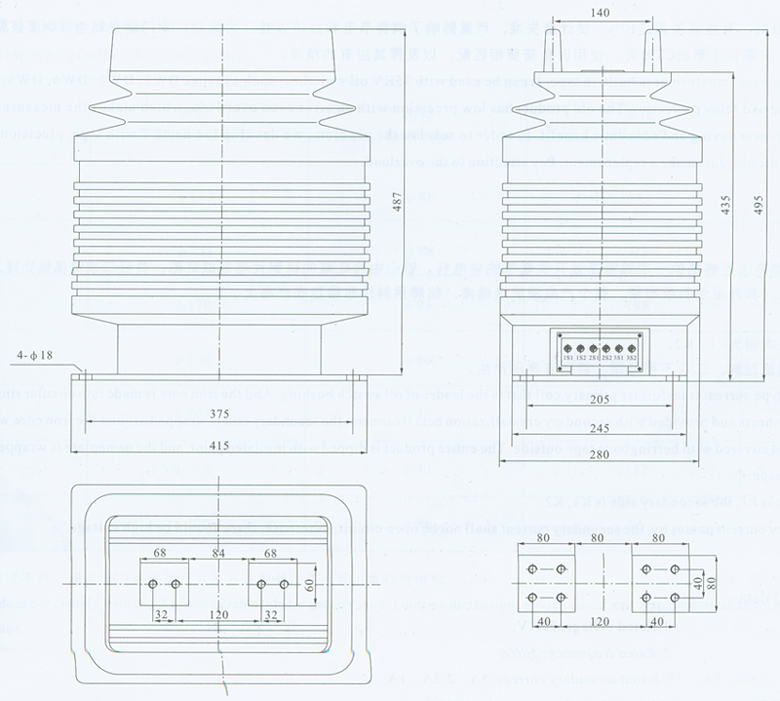

 ÍâÐμ°°²×°³ß´ç
