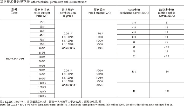

LZZB7-35GYW1 1000-2000/5Ö§ÖùʽµçÁ÷»¥¸ÐÆ÷ 1 µçѯ
LZZB7-35GYW1 400-800/5Ö§ÖùʽµçÁ÷»¥¸ÐÆ÷ 1 µçѯ
LZZB7-35GYW1 150-300/5Ö§ÖùʽµçÁ÷»¥¸ÐÆ÷ 1 µçѯ
LZZB7-35GYW1 5-100/5Ö§ÖùʽµçÁ÷»¥¸ÐÆ÷ 1 µçѯ

1. ¶î¶¨¾øÔµË®Æ½: 40.5/85/185kV£»
2. ¸ººÉ¹¦ÂÊÒòÊý : cos¦Õ=0.8(ÖͺóLag)£»
3. ¶î¶¨¶þ´ÎµçÁ÷ : 5A»ò1A£»
4. ±íÃæÅÀµç¾àÀë : Âú×ã¢ò¼¶ÎÛ»àµØÇø£»
5. ±¾²úÆ·ÊÊÓÃÓÚº£°Î¸ß¶È3000m¼°ÒÔϵØÇø£»
6. ÒÇ±í±£°²ÏµÊý: FS¡Ü10£»

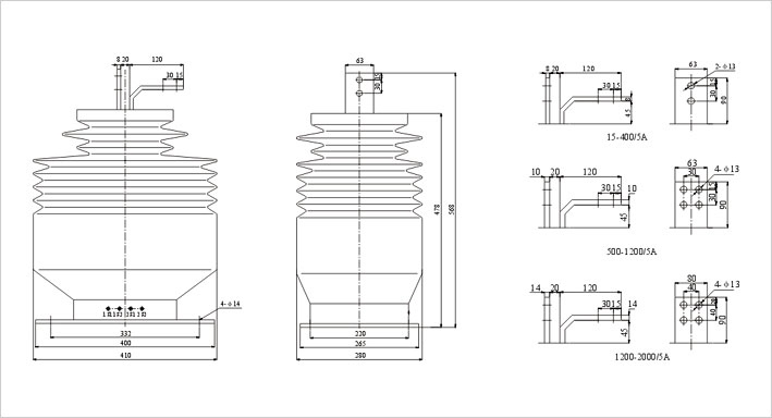

 ÍâÐμ°°²×°³ß´ç
