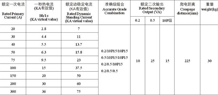

¼¼Êõ²ÎÊý
¶î¶¨¾øÔµË®Æ½£º12/42/75kV
¸ººÉµÄ¹¦ÂÊÒòÊý£ºcos¦Õ=0.8(Öͺó)
¶î¶¨¶þ´ÎµçÁ÷£º5A(»ò2A, 1A)

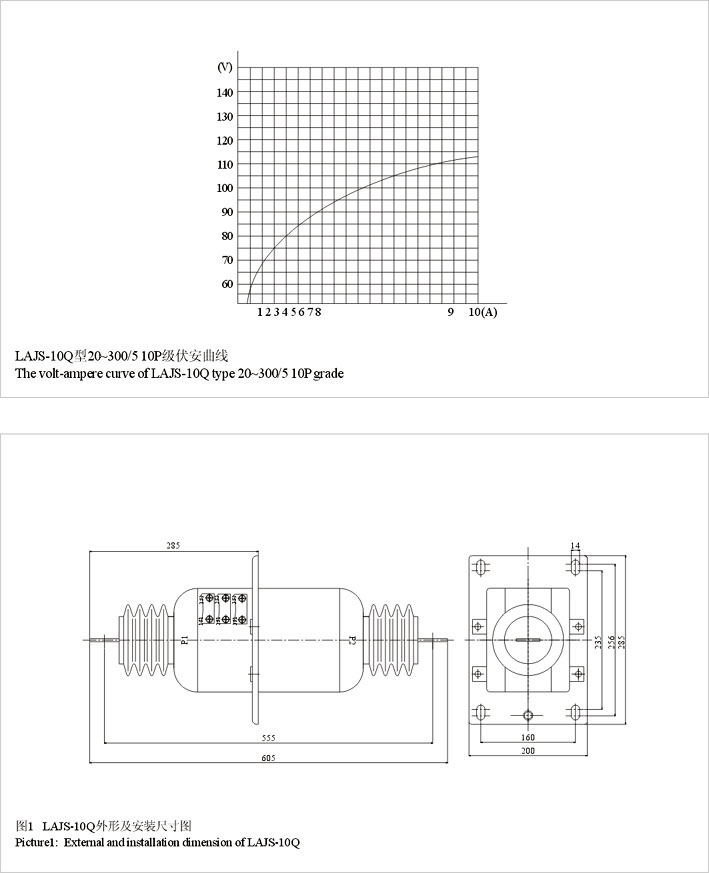

10P¼¶·ü°²ÇúÏßÈçͼËùʾ£¬¿É¹©Ñ¡ÐÍʱ²Î¿¼¡£
 ÍâÐμ°°²×°³ß´ç
