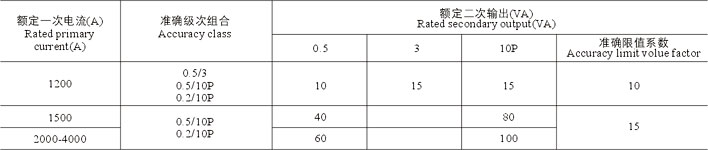

 ¼¼Êõ²ÎÊý
²úÆ·ÐÔÄÜ·ûºÏIEC ±ê×¼ºÍGB1208-1997¡¶µçÁ÷»¥¸ÐÆ÷¡·
¶î¶¨¾øÔµË®Æ½ : 12/42/75kV
¸ººÉ¹¦ÂÊÒòÊý : cos¦Õ=0.8(Öͺó Lag)
¶î¶¨ÆµÂÊ: 50Hz
¶î¶¨¶þ´ÎµçÁ÷ : 5A
±íÃæÅÀ¾àÂú×ã¢ò¼¶ÎÛ»àµØÇø¡£

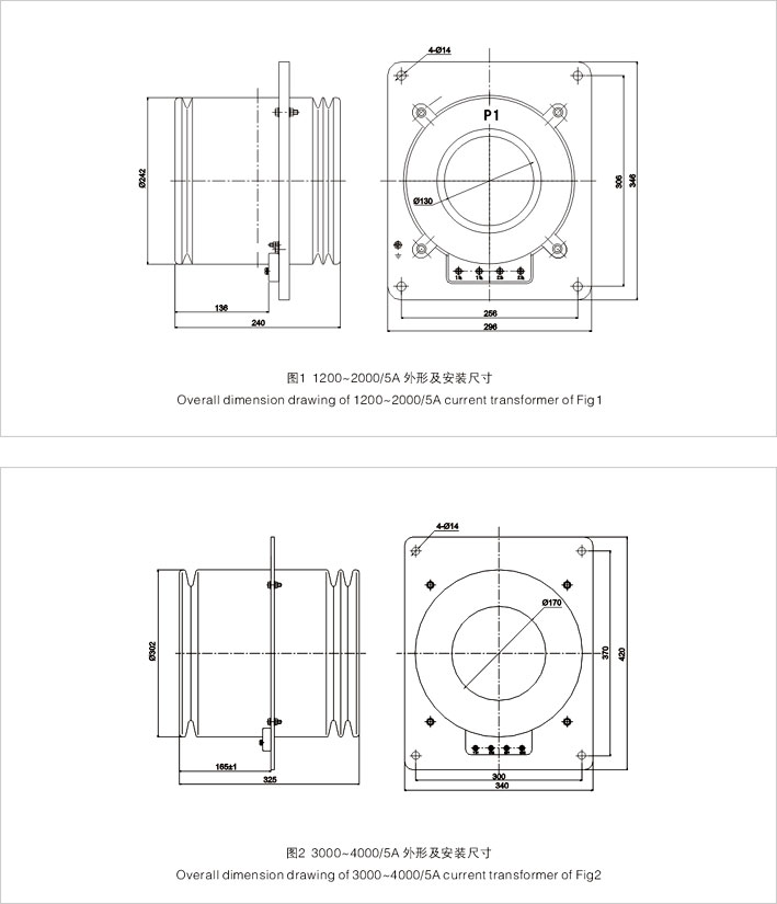

 ÍâÐμ°°²×°³ß´ç
