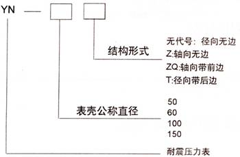

ÐͺÅÃüÃû£º
    ¼¼Êõ²ÎÊý£º

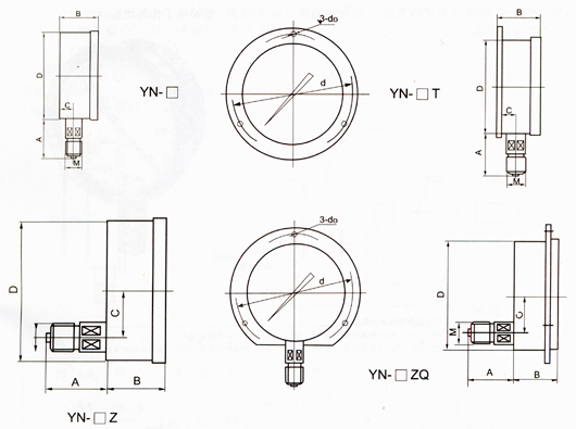

ÐͺÅ
½á¹¹ÐÎʽ
¾«È·¶È%
²âÁ¿ÉÏÏÞMPa
YN-50Z
ÖáÏòÎÞ±ß
¡À2.5
0.16£»0.25£»0.4£»0.6£»1.0£»1.6£»2.5£»4£»6£»10£»16£»25£»40£»60¡£
YN-60
YN-60T
YN-60Z
YN-60ZQ
¾¶ÏòÎÞ±ß
¾¶Ïò´øºó±ß
ÖáÏòÎÞ±ß
ÖáÏò´øÇ°±ß
YN-100
YN-100T
YN-100Z
YN-100ZQ
¾¶ÏòÎÞ±ß
¾¶Ïò´øºó±ß
ÖáÏòÎÞ±ß
ÖáÏò´øÇ°±ß
¡À1.6
-0.1£»-0.1-0.06£»-0.1-0.15£»-0.1-0.3£»-0.1-0.5£»-0.1-0.9£»-0.1-1.5£»-0.1-2.4£»0.16£»0.25£»0.4£»0.6£»1.0£»1.6£»2.5£»4.0£»6.0£»10£»16£»25£»40£»60¡£
YN-150
YN-150T
YN-150Z
YN-150ZQ
¾¶ÏòÎÞ±ß
¾¶Ïò´øºó±ß
ÖáÏòÎÞ±ß
ÖáÏò´øÇ°±ß
×¢£ºÖáÏò¿É°´ÒªÇó´ø·½ÐÎǰ±ß¡£
ʹÓù¤×÷ζȣº-5¡«55¡æ£»-25¡«55¡æ¡£
ʹÓù¤×÷»·¾³Õñ¶¯ÆµÂʲ»´óÓÚ25Hz£¬Õñ·ù²»´óÓÚ1mm¡£
ÒDZíÖ´Ðбê×¼£ºQ/320283ANTB01¡«2000
ÐͺÅ
ÍâÐγߴçmm
A
B
C
D
d
d0
M
YN-50Z
29
24
0
YN-60
YN-60T
YN-60Z
YN-60ZQ
31
31
30
30
32
32
32
32
14
15
0
0
60
/75
/75
/3.4
/3.4
1.4¡Á1.5
YN-100
YN-100T
YN-100Z
YN-100ZQ
44
44
43
43
45
46
45
45
18
19
34
44
100
/118
/118
/5.5
/5.5
20¡Á1.5
YN-150
YN-150T
YN-150Z
YN-150ZQ
51
51
47
48
47
47
19
20
55
55
149
/165
/165
/5.5
/5.5
20¡Á1.5
