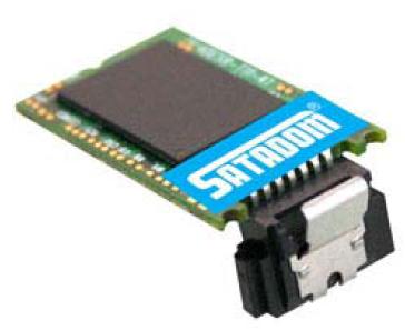

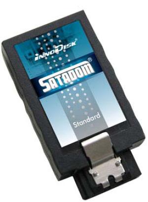

¼ò½é£º  SATADOMÊÇĿǰËù¼ûÈ«ÊÀ½ç×îСµÄSATA SSD¹Ì̬ӲÅÌ£¬²ÉÓñê×¼µÄSATA 7pin½çÃæ£¬¿É²å½ÓÓÚËùÓÐSATAÁ¬½ÓÆ÷ÉÏ£¬²»²úÉúÈκθÉÈÅ£»²»µ«ÊÇÈ«ÊÀ½ç×îСµÄSSD£¬»¹ÄÚ½¨µçÔ´¹©Ó¦£¬Ôö¼ÓÁ˼æÈÝÐԺͿɿ¿¶È¡£
  Ïêϸ˵Ã÷
                    SATADOM                                    Ë®Æ½SATADOM

ÈÝÁ¿
128MB - 8GB
½Ó¿Ú
Serial ATA I
IDE ´«Êäģʽ
PIO mode0-4£¬UltraDMA mode0-2
¼â·åËÙ¶È
150MB/sec
Êý¾Ý´«ÊäËÙÂÊ
 ¶Á : 24Mbytes/sec (max.) д : 14Mbytes/sec (max.)
ϵͳ¿É¿¿ÐÔ
ECC ¼¼Êõ
Built-in ECC corrects up to 8-bit 512Bytes
²»Õý³£µôµç
´óÓÚ3,000 ´Î
MTBF
´óÓÚ3,000,000 hours
ƽ¾ùдÈë
Ö§³Ö
Ò»°ã¼¼ÊõÒªÇó
²Ù×÷ζÈ
-10¡ã C ~ +70¡ã C (±ê×¼)
´æ´¢Î¶È
-55¡ã C ~ +195¡ã C
ʪ¶È
10% ~ 95%²»½á¶
Õð¶¯
5G(7~2000Hz)
³å»÷
50G/10ms
µçÔ´
DC ÊäÈëµçѹ
+5V single power supply operation
¹æ¸ñ
Íâ¿Ç
PC mechanical cover and UL-94
ÍâÐγߴç
Vertical type£º20.5x39.2x8mm(WxLxH)
Horizontal type£º18x30.3x9.15mm(WxLxH)
