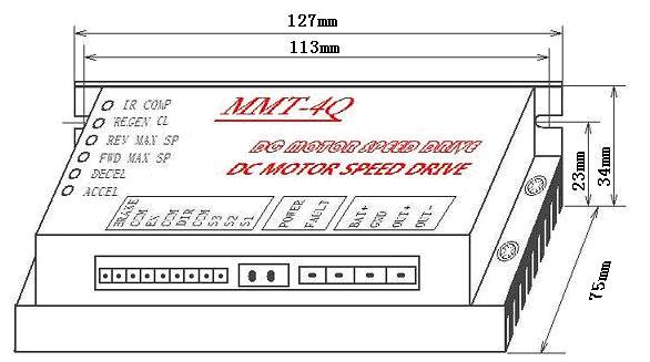

²úÆ·Ãû³Æ£º µÍѹ¿ÉÄæÖ±Á÷µç»úµ÷ËÙÆ÷
ÐÍ ºÅ£º DC24RT10BL
Æ· ÅÆ£º 614
µÍѹ¿ÉÄæÖ±Á÷µç»úµ÷ËÙÆ÷  Õý·´×ªÖ±Á÷µ÷ËÙÆ÷
MMT-DC24RT10BL
Ò»£º¹¤×÷µçѹ·¶Î§£º
DC:20-60V(¿ØÖÆÆ÷×Ô¶¯Ê¶±ð¹¤×÷µçѹ£¬²»ÐèҪѡÔñ)
¶þ£ºÌص㣺
1.Âö¿íµ÷ÖÆ
µç»úÕý³£ÔËתʱ£¬ÔëÒôС¡¢Ð§Âʸߣ¬ÄÜ´ó´óÌá¸ßµç»ú̼ˢµÄʹÓÃÊÙÃü¡£
Ìå»ýС£¬±£»¤¹¦ÄÜÆëÈ«¡£
2.ËÄÏóÏÞÔÙÉúģʽÔËÐÐ
3.ÔÙÉúÖÆ¶¯¹¦ÄÜ
  ²»ÐèÒªÍâ½Ó´¥Æ÷£¬²»»áµ¼Öµç»úÁ㲿¼þ»òת×ÓÈÆ×é¹ýÈÈ»òÕßÉÕ»Ù¡£
4.ʹÄÜ/ÖÆ¶¯/»»Ïò¿ØÖƹ¦ÄÜ
  ¿Éͨ¹ý¼òµ¥µÄ¿ª¹ØÁ¿£¨¿ª¹Ø¡¢½Ó´¥Æ÷¡¢½Ó´¥µã£©»ò¼¯µç·°å¿ªÂ·µÄ·½Ê½À´ÊµÏÖÆäÖÐ
  µÄijһ¹¦ÄܵĿØÖÆ
5.״ָ̬ʾµÆ
  µçÔ´ºÍ´íÎóָʾ ÄÜÌṩµ÷ËÙÆ÷µÄ¿ÉÊÓ»¯×´Ì¬
6.¹ýÈȱ£»¤¹¦ÄÜ
  µ±¿ØÖÆÆ÷ζȹý¸ßʱ£¬µ÷ËÙÆ÷µ÷Õûµç·½«×Ô¶¯µ÷Õû£¨½µµÍ£©ÆäÊä³ö¹¦ÂÊ£¬·ÀÖ¹³ö¹ý
  Èȱ£»¤¡£Èç¹ûζÈÈÔÈ»¹ý¸ß£¬µ÷ËÙÆ÷½«×Ô¶¯Í£Ö¹Êä³ö¡£
7.ÕýÏò¼°·´ÏòµÄËÙ¶È¡¢µçÁ÷¡¢ÈíÆô¶¯Ê±¼ä·Ö±ð¿Éµ÷
Èý£º½ÓÏß˵Ã÷
1. °´ÏÂͼÁ¬½ÓÖÆ¶¯¿ª¹Ø£¬Õýת¿ª¹Ø£¬¸ø¶¨ÊäÈë´¦½ÓÈë10k/2wµçλÆ÷¡£
2. ͨ¹ý½ÓÏßÍ­ÖùA1£¬A2Á¬½Óµ½µç»ú¡£
3. ½«µç³ØÁ¬½Óµ½£¨BAT+£©ºÍ£¨BAT-£©½ÓÏßÍ­Öù£¬×¢ÒâÕý¸º¼«ÐÔ¡£
4. ½ÓͨʹÄÜ¿ª¹Ø¼´¿É¹¤×÷¡££¨×î´óËٶȲ»Îª0ʱ£©
ËÄ£ºµçλÆ÷ÉèÖÃ˵Ã÷
1.µ÷½ÚMIN SPµçλÆ÷µÄ´óС£¬ÉèÖõç»ú×îСתËÙ¡£
2.µ÷½ÚREV MAX SP£¨FWD MAX SP£©µçλÆ÷µÄ´óС£¬ÉèÖõç»ú·´×ª£¨Õýת£©×î´óתËÙ¡£
3.µ÷½ÚDECEL µçλÆ÷µÄ´óС£¬ÉèÖÃÈíÍ£¡£
4.µ÷½ÚACCEL µçλÆ÷µÄ´óС£¬ÉèÖÃÈíÆô¡£
5.µ÷½ÚIR COMP µçλÆ÷µÄ´óС£¬ÉèÖÃÁ¦¾Ø¡£
Î壺ÔËÐÐ×´¿ö˵Ã÷
1.È·ÈÏÍâ½ÓµçÔ´¼«ÐÔÎÞÎóºóͨµç£¬Â̵ÆÁÁ¡£
2.µ±×î´óËٶȲ»Îª0ʱ£¬Í¬Ê±×îСËÙ¶ÈÒ²²»Îª0ʱ£¬Ê¹ÄܶË×ÓEN±ÕºÏ£¬µç»ú¿ªÊ¼Õý³£ÔË
  ÐУ¬Èô´Ëʱ×îСËÙ¶ÈΪ0£¬Ôòµ÷½Ú¸ø¶¨ÊäÈëµçλÆ÷µÄ´óС£¬µç»ú¿ªÊ¼Õý³£ÔËÐÐÇÒËÙ
  ¶È¿Éµ÷¡£
3.ÔÚ·½Ïò¶Ë×ÓDIR¶Ï¿ª×´¿öÏ£¬µç»úÕý³£·´×ª£¬µ±DIR¶Ë×Ó±ÕºÏʱ£¬µç»úÓÉ·´×ª×´Ì¬ÏÂ
  ¼õËÙµ½0Ôٸı䷽Ïò½øÐÐÕýת¡£¼ÓËÙ¼°¼õËÙËùÐèʱ¼äÊÓÈíÆô¼°ÈíÍ£ÉèÖöø¶¨¡£
4.µç»úÔËת¹ý³ÌÖУ¬ÈçÐè½ô¼±É²³µ£¬¿Éͨ¹ý±ÕºÏBRAKE¶Ë×ÓÀ´ÊµÏÖ¡£
5.Õý³£ÔËÐÐ״̬ÏÂcoil+£¬coil-¶Ë×ÓÖ®¼äÊä³öÔ¼24vÖ±Á÷µçѹ¡£
6.µ÷ËÙÆ÷¹¤×÷Ò쳣ʱ£¬ºìµÆÁÁ½øÐб¨¾¯£¬µç»úÍ£Ö¹ÔËת¡£½â³ý±¨¾¯Ö»Ðè¶ÏµçºóÖØÐÂËÍ
  µç¼´¿É¡£¹¤×÷ÖпÉÄܳöÏÖµÄÒì³£×´¿ö¼û¸½Â¼¡£
Áù£ºµ÷ËÙÆ÷²ÎÊý
Ö±Á÷ÊäÈëµçѹ£ºDC20-62V
Ö±Á÷Êä³öµçѹ£ºÊäÈëµçѹµÄ0-100%
Á¬Ðø¹¤×÷µçÁ÷£º10A £¨Ë®Æ½°²×°Ê±½µµÍ20%£©
1·ÖÖÓ·åÖµµçÁ÷£º25A     Ëٶȵ÷½Ú£º1%
ËÙ¶È·¶Î§£º80 £º1        »·¾³Î¶ȣº10-40¡æ
¸½Â¼£º
ºìµÆÌáʾ
Òì³£Çé¿ö
³£ÁÁ
µ÷ËÙÆ÷×Ô¶¯ÏÞÁ÷±£»¤
Á¬ÐøÉÁ˸Á½ÏÂ
µ÷ËÙÆ÷µÍѹ×Ô¶¯ÌøÕ¢
Á¬ÐøÉÁ˸ÈýÏÂ
µ÷ËÙÆ÷¸ßѹ×Ô¶¯ÌøÕ¢
Á¬ÐøÉÁ˸ËÄÏÂ
µ÷ËÙÆ÷µçÁ÷¶ÌÂ·ÌøÕ¢
Á¬ÐøÉÁ˸ÎåÏÂ
µ÷ËÙÆ÷¹ýÈÈ´ïµ½100¡æ¼´ÌøÕ¢±£»¤£¬µç»úÍ£Ö¹ÔËÐÐ
