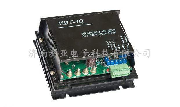

²úÆ·Ãû³Æ£º µÍѹ¿ÉÄæÖ±Á÷µç»úµ÷ËÙÆ÷24RT50BL
ÐÍ ºÅ£º 24RT50BL
Æ· ÅÆ£º 614
MMT-24RT30-50BL

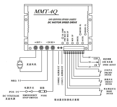

Ò»¡¢Ìص㣺
¸ÃϵÁе÷ËÙÆ÷ΪµÍѹֱÁ÷ËÄÏóÏÞÔÙÉúÂö¿íµ÷ËÙ£¬²ÉÓÃרÓõ¥Æ¬»úÖÇÄÜ¿ØÖÆ£¬ÏàÓ¦Ëٶȿ졢ÔËתƽÎÈ¡¢¹¤×÷¿É¿¿¡¢±£»¤¹¦ÄÜÆëÈ«µÈ¡£
©~ Âö¿íµ÷ÖÆ
   µç»úÔËתÔëÒôС¡¢Ð§Âʸߡ¢µÍά»¤¡¢¸üºÃµÄÌá¸ßÖ±Á÷µç»úµÄʹÓÃÊÙÃü
©~ ËÄÏóÏÞÔÙÉúÔËתģʽ
©~ ÔÙÉúÖÆ¶¯
   ²»ÐèÒªÍⲿ»»Ïò½Ó´¥Æ÷£¬²»»áµ¼Öµç»úÁ㲿¼þ»òÆä×é¼þ¹ýÈÈ»òÕßÉÕ»Ù
©~ ʹÄÜ/ÖÆ¶¯/»»Ïò¶Ë×Ó
   ͨ¹ý¼òµ¥µÄÎÞÔ´¿ª¹ØÁ¿»ò¾§Ìå¹Ü¼¯µç¼«¿ªÂ·À´ÊµÏÖÆäÖеÄijһ¹¦Äܼ´¿É
©~ ״ָ̬ʾµÆ
µçԴָʾºÍ¸÷ÖÖ¹ÊÕϱ¨¾¯Ö¸Ê¾ÄÜÌṩµ÷ËÙÆ÷µÄ¿ÉÊÓ»¯×´Ì¬
©~ Õý/·´ÏòתËÙ¿É·Ö±ðÉ趨
©~ Êä³öµçÁ÷É趨¹¦ÄÜ
©~ ÖÆ¶¯µçÁ÷É趨¹¦ÄÜ
©~ ת¾Ø²¹³¥¹¦ÄÜ
©~ ±ê׼ģÄâÁ¿ÐźſØÖÆ
   Ä£ÄâÁ¿£º0-5V »ò µçλÆ÷¿ØÖƾù¿É
©~ ¹ýÈȱ£»¤¹¦ÄÜ
  µ±Î¶ȹý¸ßʱ£¬µ÷ËÙÆ÷½«Í¨¹ýζÈÅжϵç·½µµÍÆäÊä³öµçÁ÷£¬ÒÔ·ÀÖ¹
  ¹ýÈȱ£»¤£¬Èç¹ûζÈÈÔÈ»¹ý¸ßµ÷ËÙÆ÷½«Í£Ö¹Êä³ö¸üºÃµÄ±£»¤µç»ú¼°µ÷ËÙÆ÷µÄ°²È«
