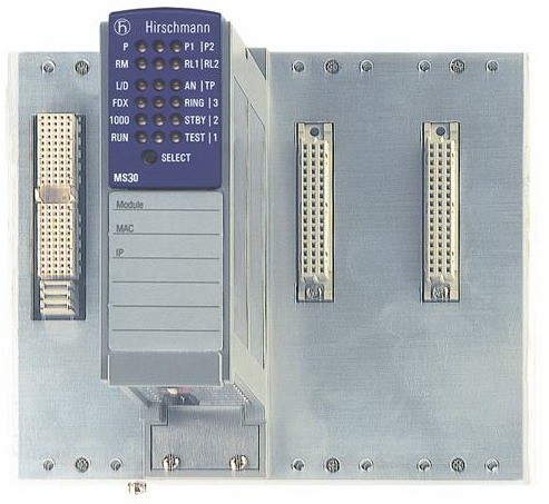

²úÆ·Ãû³Æ£º µÂ¹úºÕ˹ÂüMS30-0802SAAEHCǧÕ×Ä£¿é»¯½»»»»ú
ÐÍ ºÅ£º MS30-0802SAAEHC
Æ· ÅÆ£º 1033
µã»÷²ì¿´Ô­Í¼
²úÆ·¼ò½é£º
ǧÕ×Ä£¿é»¯½»»»»ú£¬8¸ö°ÙÕ׶˿ڣ¬2¸öǧÕ×¶Ë¿Ú
Ïêϸ½éÉÜ£º
MS30 --- ½»»»»úÀàÐÍ
RS20£ºÒ»Ì廯°ÙÕ×ÉÏÁª½»»»»ú
RS30£ºÒ»Ì廯ǧÕ×ÉÏÁª½»»»»ú
MS20£ºÄ£¿é»¯°ÙÕ×ÉÏÁª½»»»»ú
MS30£ºÄ£¿é»¯Ç§Õ×ÉÏÁª½»»»»ú
08 --- °ÙÕ×¶Ë¿ÚÊýÁ¿
04£º4 * 100 Mbit
08£º8 * 100 Mbit
16£º16 * 100 Mbit
24£º24 * 100 Mbit
02 --- ǧÕ×ÉÏÁª¶Ë¿ÚÊýÁ¿
00£º0 * 1000 Mbit
02£º2 * 1000 Mbit
S --- ζȷ¶Î§
S£º0¡ãC~+60¡ãC
T£º-40¡ãC~+70¡ãC
E£º-40¡ãC~+70¡ãC£¬´ø±£»¤Í¿²ã
A --- ¹©µç·½Ê½
A£º18~32 VDC
C£º32~60 VDC
A --- ÈÏÖ¤
A£ºcUL508£¬cUL1604 Class1 Div.2
H£ºcUL508£¬cUL1604 Class1 Div.2£¬Substation IEC61850£¬Railway (track)
B£ºcUL508£¬cUL1604 Class1 Div.2£¬GL£¬substation IEC61850£¬Railway (track and train)£¬ATEX 100a Zone 2
E --- Èí¼þ°æ±¾
E£ºÔöÇ¿°æ: Ô¶³Ì·ÃÎÊ£¬Õï¶Ï£¬¹ýÂË£¬ÈßÓà
P£º×¨Òµ°æ: °üÀ¨ÔöÇ¿°æµÄ¹¦ÄÜ£¬¼ÓÉÏÔöÇ¿µÄ°²È«¡¢À©Õ¹µÄÕï¶ÏºÍÈßÓ๦ÄÜ
ÔöÇ¿°æÈí¼þ¹¦ÄÜÖ§³Ö£º
HIPER-Ring£¬¿ìËÙÉú³ÉÊ÷RSTP£¬»·¼äñîºÏ£¬dual homing£¬ÈßÓà24V¹©µç
´®ÐнӿÚ,web½çÃæ,SNMP V1/V2/V3,HiVision,ͨ¹ýHTTP/FTP¸üÐÂfirmware
LEDs, ÐźŴ¥µã(24 V DC / 1 A), ϵͳÈÕÖ¾,ÈÕÖ¾Îļþ,RMON,¶Ë¿Ú¾µÏñ,ÍØÆÓ·¢ÏÖIEEE802.1AB
ÃüÁîÐнӿÚ(CLI), TELNET, BootP, DHCP, DHCP Option 82, ACA×Ô¶¯ÅäÖÃÊÊÅäÆ÷(ACA21-USB), HiDiscovery
¶Ë¿Ú°²È«(»ùÓÚMACºÍIP), SNMP V3(·Ç¼ÓÃÜ)
4¸ö¼¶±ðµÄQoS, IEEE802.1D/qÓÅÏȼ¶, IEEE802.1Q VLAN, ×é²¥(IGMP Snooping/querier), GMRP, ×é²¥Õì²â£¬¹ã²¥ÏÞÖÆÆ÷, ¶Ë¿ÚµØÖ·¿ìËÙË¢ÐÂ
IEEE802.3XÁ÷Á¿¿ØÖÆ£¬802.1D/p¶Ë¿ÚÓÅÏÈ£¬TOS(·þÎñÀà±ð)Diff-Serv
רҵ°æÈí¼þ¹¦ÄܳýÔöÇ¿°æËùÓй¦ÄÜÍ⣬»¹Ö§³Ö£º
´øÄÜÁ¿»º³åµÄʵʱʱÖÓ
×é²¥ GMRP IEEE 802.1D
SNMP V3£¬SSH£¬IEEE802.1XÈÏÖ¤
MAC/IPÓÅÏȼ¶£¬TOS-Prio-Mapping, Á÷Á¿ÕûÐÎ(µ¥²¥£¬×é²¥£¬¹ã²¥)£¬ingress / egress
