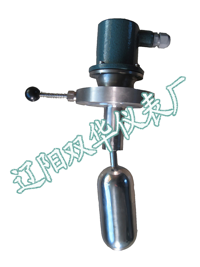

²úÆ·Ãû³Æ£º UQK-01-C-Z×Ô¼ìʽ´¬Óø¡ÇòҺλ¿ØÖÆÆ÷
ÐÍ ºÅ£º UQK-01-C-Z
¼¼Êõ²ÎÊý    TECHNICAL SPECIFICATION
ÐÍ    ºÅ Model
UQK-01-C -Z
UQK-01-C/B-Z
°²×°ÐÎʽ Mounting type
²à   ×° Horizontal mounting
¿ª¹Ø½á¹¹ Switch type
µ¥µãÁ½Î»Ê½ SPDT
´¥µãÈÝÁ¿ Contact capacity
SPDT AC;220/10A DC125V/0.6A
Çл»²îmm Switching error
10¡«30£¨mm£©
½é×Ó±ÈÖØ Medium gravity
¡Ý0.85
½é×ÓÎÂ¶È Medium temp
¡Ü200¡æ
¹¤×÷ѹÁ¦ Working pressure
1.0MPa
·À±¬±ê¼Ç
EXdIIBT3¡«T5
·À»¤µÈ¼¶ Protection
IP68
Õû¶¨·½Ê½ Regulated type
¶¨Öµ²»¿Éµ÷ Fixed £¦#118alue£¦unadjustable
¸¡ÇòÖ±¾¶ Float dia D mm
¦µ60
ÐÍ    ºÅ Model
UQK-01-C -Z
UQK-01-C/B-Z
µ¥µãÁ½Î»Ê½ SPDT
10¡«30£¨mm£©
¡Ý0.85
¡Ü200¡æ
1.0MPa
·À±¬±ê¼Ç
EXdIIBT3¡«T5
·À»¤µÈ¼¶ Protection
IP68
¦µ60
