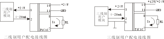

ËÄ¡¢²úÆ·½ÓÏßͼ
×¢£º½ÓÏßͼ½ö¹©²Î¿¼£¬¾ßÌå½ÓÏßÒÔ²úÆ·Íâ¿Ç±êǩΪ׼¡£

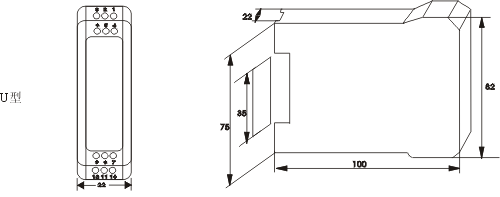

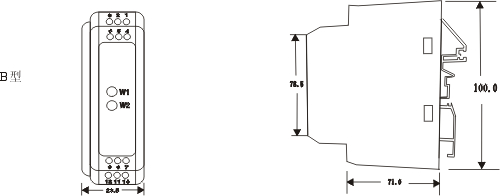

Îå¡¢ÍâÐμ°°²×°³ß´ç
Áù¡¢µäÐͽÓÏß
