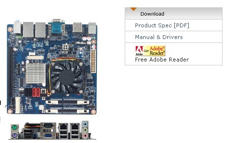

Specifications
System
CPU
Intel® SV/LV/ULV-i7/ i5/ i3/ Celeron
BIOS
Insyde uEFI 64Mb SPI BIOS
System Chipset
Intel® QM57/HM55
I/O Chip
Winbond W83667HG-A
System Memory
Two SODIMM support up to 8GB dual channel
DDR3 1066/ 800 SDRAM
Watchdog Timer
Reset : 1 to 255 sec/min per step
H/W Status Monitor
Monitoring CPU temperature, voltage, and cooling fan status. Auto throttling control when CPU overheats
Expansion
1 PCI-E x 16 (PEG & SDVO), 1 Mini PCI-E x1
Power State
S1, S3, S4, S5
Wake up on LAN or Ring
WOL & WOR
SmartFan Control
Yes
I/O
MIO
2 COM RS-232 (1F/1R) with power, 4 SATA II, 1 DisplayPort, 1 HDMI, 1 VGA, 1 LVDS, 1 LVDS Backlight
USB
8 USB 2.0 (4F/4R)
GPIO
8-bit General Purpose I/O for 4-bit DI and 4-bit DO
Display
Chipset
Intel® QM57/ HM55
Display Memory
Intel Arrandale IGD supports DVMT 5.0
Max. Resolution
2048 x 1536 @ 75 MHz
Dual Display
VGA+LVDS, VGA+DP, VGA+HDMI
VGA
On board
LVDS
Yes, through internal LVDS connector
LVDS Backlight Power Connector
Yes, through internal LVDS Backlight Connector
DisplayPort
On board
DVI
No, need DVI Dongle (from DP connector)
HDMI
On Board (HDMI 1.3)
Audio
Audio Codec
Realtek ALC888, 5.1 + 2 Channel with Multiple Streaming HD Audio
Audio Interface
Line-in, Line-out, Mic-in
Ethernet
LAN 1
Intel 82577-LM Gigabit LAN
LAN 2
Realtek RTL8111C Gigabit LAN
Back Panel I/O Port
Back Panel I/O Port
1 PS/2 Keyboard,
1 PS/2 Mouse,
1 DisplayPort,
1 HDMI Port,
1 VGA Port,
1 COM RS-232 Port,
2 LAN RJ45 Ports,
2 USB 2.0 Ports,
Audio I/O (3 jacks)
Internal I/O Connector
2 USB Connectors support 4 USB Ports,
1 LDVS Connector,
1 Backlight Connector,
4 SATA Connectors,
1 CPU Fan Connector,
1 Chassis Fan Connector,
1 Front Panel Header,
1 RS-232 Pin Header,
1 GPIO,
1 Front Audio Header
Mechanical & Environmental
Power Requirement
+12V +5V +3.3V 5VSB
1.66A 3.51A 1.08A 570mA
Power Type
ATX
Power Connector
1 24-pin ATX Power Connector,
1 4-pin ATX 12V Power Connector
Operating Temperature
0 to 60¡ãC (32 to 140¡ãF)
Operating Humidity
0% to 90% relative humidity, non-condensing
Size (L x W)
6.69" x 6.69" (170 mm x 170 mm)
Weight
1.03lbs (0.47Kg)
