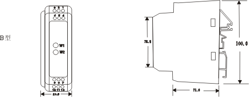

ËÄ¡¢²úÆ·½ÓÏßͼ
×¢£º½ÓÏßͼ½ö¹©²Î¿¼£¬¾ßÌå½ÓÏßÒÔ²úÆ·Íâ¿Ç±êǩΪ׼¡£

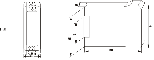

Îå¡¢ÍâÐμ°°²×°³ß´ç

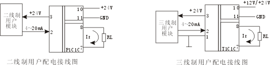

Áù¡¢µäÐͽÓÏß
