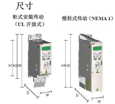

ÍâÐιæ¸ñ
IP 20 UL ¿ª·Åʽ
NEMA 1
H1 mm
H2 mm
H3 mm
W mm
D mm
H4 mm
H5 mm
W mm
D mm
R0
169
202
239
70
142
257
280
70
142
R1
169
202
239
70
142
257
280
70
142
R2
169
202
239
105
142
257
282
105
142
H1 = ¸ß¶È£¬Ã»Óнô¹Ì¼þ¼°¼Ð°å
H2 = ¸ß¶È£¬Óнô¹Ì¼þµ«Ã»Óмаå
H3 = ¸ß¶È£¬Óнô¹Ì¼þ¼°¼Ð°å
H4 = ¸ß¶È£¬Óнô¹Ì¼þ¼° NEMA 1 ½ÓÏߺÐ
H5 = ¸ß¶È£¬Óнô¹Ì¼þ¡¢NEMA 1 ½ÓÏߺм°»úÕÖ
W = ¿í¶È
D = ºñ¶È
