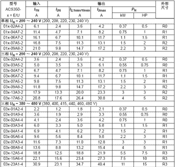

ÐͺŴúÂë
ÐͺŴúÂ루ÉÏÊö¼°ÓÒ±íµÚËÄÁУ©Çå³þµØ±íÃ÷ÁË´«¶¯µÄ¹¦ÂʶֵºÍÍâÐιæ¸ñ¡£Ñ¡¶¨Ðͺźó£¬ÍâÐιæ¸ñ£¨µÚÎåÁУ©¿ÉÓÃÀ´È·¶¨´«¶¯³ß´ç£¬ÏêÇé¼ûÏÂÒ³Ëùʾ¡£
µçѹ
ACS350ÌṩÁ½ÖÖµçѹ·¶Î§:
2 = 200 - 240 V
4 = 380 - 480 V
¸ù¾ÝËùÑ¡¶¨µÄµçѹ£¬ÔÚÉÏÊöµÄÐͺŴúÂëÖÐÌîд
½á¹¹
ÉÏÊöÐͺŴúÂëÖеÄEMCÂ˲¨Æ÷Á¬½ÓÇé¿ö¡£¿É¸ù¾ÝÐèÒª½øÐÐÑ¡Ôñ£¬¾ßÌåÈçÏ£º
01 = µ¥Ïà
03 = ÈýÏà
E = EMCÂ˲¨Æ÷Á¬½Ó£¬50 HzƵÂÊ
U = EMCÂ˲¨Æ÷¶Ï¿ª£¬60 HzƵÂÊ
ÐèҪʹÓÃÂ˲¨Æ÷ʱ£¬¿É·½±ãµØ½Óͨ¡£
ÐͺŴúÂëÖеÄX±íʾE»òU¡£

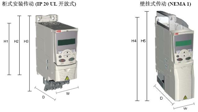

ÍâÐιæ¸ñ
NEMA 1
H1 mm
H2
mm
H3 mm
W mm
D mm
ÖØÁ¿kg
H4mm
H5mm
W
mm
D
mm
kg
R0
169
202
239
70
162
1.1
257
280
70
1.5
R1
169
202
239
70
162
1.3
257
282
70
1.7
R2
169
202
239
105
162
1.5
257
282
105
1.9
R3
169
202
236
169
169
2.5
260
299
169
H1 = ¸ß¶È£¬Ã»Óнô¹Ì¼þ¼°¼Ð°å            H2 = ¸ß¶È£¬Óнô¹Ì¼þµ«Ã»Óмаå
H3 = ¸ß¶È£¬Óнô¹Ì¼þ¼°¼Ð°å              H4 = ¸ß¶È£¬Óнô¹Ì¼þ¼°½ÓÏߺÐ
H5 = ¸ß¶È£¬Óнô¹Ì¼þ¡¢½ÓÏߺм°»úÕÖ     W = ¿í¶È      D = ºñ¶È
