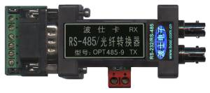

²¨Ê˵ç×ÓµÄOPT232TLS£¨µ¥Ä££©ÐÍRS-232/TTL/¹âÏËת»»Æ÷ÓÃÓÚʵÏÖRS-232µçƽ¡¢TTLµçƽµÄ¹âÏË´«Êä¡¢ÊÇÊÀ½çÉÏ×îСµÄµ¥Ä£´®¿Ú/¹âÏËת»»Æ÷¡£OPT232TLS¾ßÓÐRS-232½Ó¿ÚÒÔ¼°TTL½ÓÏß¶Ë×Ó£¬µçÔ´½ÓÏß¶Ë×Ó£¬¿ÉÒÔÔÚ¿Á¿ÌµÄÌõ¼þÏÂʵÏÖ¹âÏËͨÐÅ¡£
¶þ¡¢Ó²¼þ°²×°
 OPT232TLSÐÍRS-232/TTL/¹âÏËת»»Æ÷£¨µ¥Ä££©µÄÍâÐÎΪDB-25/DB-25ת½ÓºÐ´óС£¬ÆäÖÐDB-25(¿××ù)Ò»¶ËΪRS-232µçƽ£¬ÁíÍâÒ»¶ËΪһ¶ÔST¹âÏ˽ÓÍ·¡£ÉϲàÃæÓÐTTLµçƽµÄ½ÓÏß¶Ë×Ó¡¢Ï²àÃæÓÐ5VµçÔ´½ÓÏß¶Ë×Ó¡£
OPT232TLSµÄDB-25¿×¶Ë¿ÉÒÔͨ¹ý±ê×¼µÄDB25Õë/DB9¿×ת½ÓÏߣ¨²úÆ·ÅäÌ×ÔùËÍ£©Íâ²å¼ÆËã»úµÄDB-9ÕëRS-232¿Ú£¬»òÕßÖ±½ÓÍâ²åDB-25ÕëµÄRS-232¿Ú£¨Õë×ù£©¡¢Ö»Óõ½RXD-2¡¢TXD-3¡¢GND-5Èý¸öÐźÅÏß¡£TTLµçƽµÄÒý½ÅλÓÚ²úÆ·ÉϲàÃæ£¬ÈçÏÂÃæµÄ²úƷͼËùʾ¡£TTLÒý½Å¹²3¸ö½ÓÏß¶Ë×Ó£¬ÖмäÒ»¸öΪGNDµØÏߣ¬×óÓÒÁ½²à·Ö±ðΪÊÕ·¢ÐźÅÏߣ¬×¢ÒâͼʾµÄTTLÐźŵĽÓÊÕ¡¢·¢ËÍÁ÷Ïò¡£
OPT232TLSͨ¹ýÌøÏßÉèÖÃÀ´Ñ¡ÔñÊǽÓRS-232»¹ÊÇTTL¡£ÌøÏßλÓÚTTL½ÓÏß¶Ë×ÓµÄÅԱߡ£½ÓRS-232¿ÚÊ±ÌøÏß¿¿RS-232¿Ú²à¶Ì½Ó¡£½ÓTTLÊ±ÌøÏß¿¿¹âÏ˲à¶Ì½Ó¡£
OPTϵÁйâÏËת»»Æ÷ʹÓÃʱ·¢ËÍÆ÷STͷͨ¹ý¹âÏ˽ӶԷ½µÄ½ÓÊÕÆ÷STÍ·¡£Íâ½Ó5VµçÔ´ÒªÇó4.5 Vµ½5.5V£¬Ëæ²úÆ·ÅäÌ×Ãâ·ÑÌṩµçÔ´£¬²úÆ·¹¦ºÄСÓÚ100mA¡£²¨Ê˵ç×ÓÅäÌ×Ìṩ¸÷ÖÖ¹âÏËÒÔ¼°½ÓÍ·¡£
