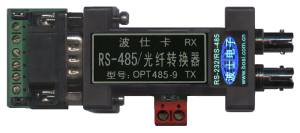

²úÆ·Ãû³Æ£º ²¨ÊËRS232/RS485/422/¹âÏËת»»Æ÷ OPT485-9
ÐÍ ºÅ£º OPT485-9
Æ· ÅÆ£º 1047
OPT485-9--- 1380Ôª
³¬Ð¡ÐÍRS-232/485/422/¹âÏËת»»Æ÷  115.2KBPS  DB-9  70¿Ë  ÓÐÔ´

²¨Ê˵ç×ÓµÄOPT485-9³¬Ð¡ÐÍRS-232/485/422/¹âÏËת»»Æ÷¾ßÓв¨ÊËOPT485ϵÁÐRS-232/485/422/¹âÏËת»»Æ÷µÄÈ«²¿¹¦ÄÜ£¬Ìå»ý¸üС£¬²¢ÇÒ¿ÉÒÔÖ±½ÓÍâ²åDB-9ÕëRS-232¿Ú¡£¸ÃϵÁвúÆ·ÊDz¨Ê˵ç×ÓµÄרÀû²úÆ·£¬ÓµÓÐ200530102023.5ºÅÖйúרÀû£¬ÊDz¨Ê˵ç×Ó·¢Ã÷ºÍÊ×´´µÄÊÀ½çÉÏ×îСµÄÈ«´®¿Ú£¨RS-232/RS-485/RS-422£©Óë¹âÏ˵Äת»»Æ÷¡£ÓÉÓÚ²ÉÓùâÏË×÷ΪͨÐÅ´«Êä½éÖÊ£¬¾ßÓи߸ôÀëµçѹ¡¢·Àµç´Å¸ÉÈÅ¡¢¿¹À×»÷µÈÓŵ㡣²¨Ê˹âÏËת»»Æ÷¹ã·ºÓÃÓÚ¸÷ÖÖ¹¤Òµ¹ý³Ì¿ØÖÆ¡¢·Ö²¼Êý¾Ý²É¼¯µÈ³¡ºÏ¡¢ÌرðÊʺϵçÁ¦ÏµÍ³×Ô¶¯»¯¡¢½»Í¨¿ØÖƵȲ¿ÃÅ¡£
¶þ¡¢Ó²¼þ°²×°
 OPT485-9ÐÍRS-232/485/422/¹âÏËת»»Æ÷£¨¶àÄ££©µÄÍâÐÎΪDB-9/DB-9ת½ÓºÐ´óС£¬ÆäÖÐDB-9(¿××ù)Ò»¶ËÖ±½Ó²åÔÚDB-9оRS-232Õë×ùÉÏ¡¢Íâ½Ó5VµçÔ´£¬Ê¹ÓÃÒ»¶ÔST¹âÏ˽ÓÍ·¡£
OPTϵÁйâÏËת»»Æ÷ʹÓÃʱ·¢ËÍÆ÷ͨ¹ý¹âÏ˽ӶԷ½µÄ½ÓÊÕÆ÷¡£
×¢Òâ±£³Ö¹âÏËת»»Æ÷µÄST×ù»òÕßFC×ùµÄÇå½à¡¢Èç¹û²»Á¬½ÓʱÇëÒ»¶¨ÓÃÏàÅäÌ×µÄÏðƤÈû×Ó¸Çס¡£
Èý¡¢ÐÔÄÜÌØµã
    ²¨Ê˵ç×ÓµÄOPTϵÁÐRS-232/485/422/¹âÏËת»»Æ÷×î¸ßËÙÂÊ115.2KbpsÒÔÉÏ¡£¾ùÎÞÐèÈκγõʼ»¯ÉèÖã¡¶ÀÓв¨ÊËÁãÑÓʱ×Ô¶¯ÊÕ·¢×ª»»¼¼Êõ£¬È·±£ÊʺÏËùÓÐÈí¼þ! OPT485-9µÄDB-9¿×¶Ë¿ÉÒÔÖ±½ÓÍâ²åPC»úµÄDB-9ÕëRS-232¿Ú£¨Õë×ù£©¡¢Ö»Óõ½RXD-2¡¢TXD-3¡¢GND-5Èý¸öÐźÅÏß¡£

½ÓRS-232£¨²»ÓöË×Ó¡¢¼Ó5VµçÔ´£©
½ÓRS-485 £¨J1¡ª°ë¡¢J2¶Ì½Ó¡¢J3¶Ì½Ó£©
ÔÚÆäÖÐÈÎÒ»¸ö±êÓÐ ¡°+5V GND¡±µÄµØ·½¼ÓµçÔ´£¨²»ÒªÍ¬Ê±ÔÚÁ½¸öµØ·½¼ÓµçÔ´£©
½ÓRS-422 £¨J1¡ªÈ«¡¢J2¶Ï¿ª¡¢J3¶Ï¿ª£©
