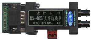

²¨Ê˵ç× OPT232TL£¨¶àÄ££©ÐÍRS-232/TTL/¹âÏËת»»Æ÷ÓÃÓÚʵÏÖ RS-232µçƽ¡¢TTLµçƽµÄ¹âÏË´«Êä¡¢ÊÇÊÀ½çÉÏ×îСµÄ´®¿Ú/¹âÏËת»»Æ÷¡£OPT232TL¾ßÓÐRS-232½Ó¿ÚÒÔ¼° TTL½ÓÏß¶Ë×Ó£¬µçÔ´½ÓÏß¶Ë×Ó£¬¿ÉÒÔÔÚ¿Á¿ÌµÄÌõ¼þÏÂʵÏÖ¹âÏËͨÐÅ¡£
2¡¢Ó²¼þ°²×°
OPT232TLÐÍ RS-232/TTL/¹âÏËת»»Æ÷£¨¶àÄ££©µÄÍâÐÎΪ DB-9/DB-9ת½ÓºÐ´óС£¬ÆäÖÐ DB-9(¿××ù)Ò»¶ËΪ RS-232µçƽ£¬ÁíÍâÒ»¶ËΪһ¶Ô ST¹âÏ˽ÓÍ·¡£ÉϲàÃæÓÐ TTLµçƽµÄ½ÓÏß¶Ë×Ó¡¢Ï²àÃæÓÐ 5VµçÔ´½ÓÏß¶Ë×Ó¡£
OPT232TLµÄ DB-9 ¿×¶Ë¿ÉÒÔÖ±½ÓÍâ²å PC»úµÄ DB-9 Õë RS-232¿Ú£¨Õë×ù£©¡¢Ö»Óõ½ RXD-2¡¢TXD-3¡¢GND-5 Èý¸öÐźÅÏß¡£TTLµçƽµÄÒý½ÅλÓÚ²úÆ·ÉϲàÃæ£¬ÈçÏÂÃæµÄ²úƷͼËùʾ¡£TTLÒý½Å¹²3 ¸ö½ÓÏß¶Ë×Ó£¬ÖмäÒ»¸öΪ GNDµØÏߣ¬×óÓÒÁ½²à·Ö±ðΪÊÕ·¢ÐźÅÏߣ¬×¢ÒâͼʾµÄ TTLÐźŵĽÓÊÕ¡¢·¢ËÍÁ÷Ïò¡£OPT232TLͨ¹ýÌøÏßÉèÖÃÀ´Ñ¡ÔñÊÇ½Ó RS-232»¹ÊÇTTL¡£ÌøÏßλÓÚ TTL½ÓÏß¶Ë×ÓµÄÅԱߡ£½ÓRS-232¿ÚÊ±ÌøÏß¿¿ RS-232¿Ú²à¶Ì½Ó¡£½ÓTTLÊ±ÌøÏß¿¿¹âÏ˲à¶Ì½Ó¡£OPTϵÁйâÏËת»»Æ÷ʹÓÃʱ·¢ËÍÆ÷ST ͷͨ¹ý¹âÏ˽ӶԷ½µÄ½ÓÊÕÆ÷ST Í·¡£Íâ½Ó 5VµçÔ´ÒªÇó 4.5Vµ½5.5V£¬Ëæ²úÆ·ÅäÌ×Ãâ·ÑÌṩµçÔ´£¬²úÆ·¹¦ºÄСÓÚ 100mA¡£
3¡¢ÐÔÄÜÌØµã
²¨Ê˵ç× OPT232TL¹âÏËת»»Æ÷ËÙÂÊ 0¡ª115.2Kbps¡£¾ùÎÞÐèÈκÎÈí¼þ³õʼ»¯ÉèÖã¡È·±£ÊʺÏËùÓÐÈí¼þ¼°´®¿Ú¹âÏ˽ӿÚ!
¹âÏË½Ó¿Ú :ST£¨¿ÉÑ¡ FC¡¢SC£©
µçÆø½Ó¿Ú: DB-9¡¢DB-25
´«Êä½éÖÊ: Ë«¶àÄ£¹âÏË
³ß´ç¼°ÖØÁ¿:DB-9/9 ת½ÓÍ·´óС¡¢70¿Ë¡¢17*33*77mm
ͨÐÅ·½Ê½: ±ê×¼ RS-232µçƽ¡¢TTLµçƽ/ËÙÂÊ£º0¡ª115.2Kbps ´«Êä¾àÀë 4Km£¨¶àÄ££©
¹â²¨³¤ :820nm£¨¶àÄ££©
ÊÊÓùâÏË 50/125¡¢62.5/125¡¢100/140um
