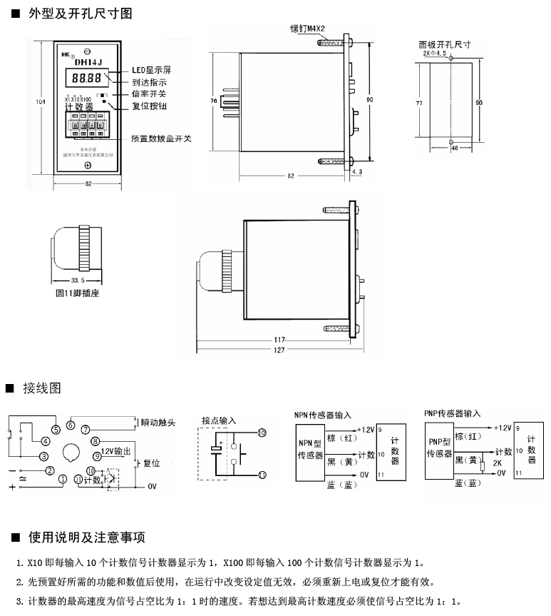

􀂄 ÌØµã
􀁺 µÚÒ»´úÔ¤ÖüÆÊýÆ÷£¬×¼òµÄ¹¦ÄÜ£¬¾­¶à´Î¸ÄÁ¼ÐÔÄÜÎȶ¨¿É¿¿
􀁺 ÄÚÖÃ΢´¦ÀíÆ÷
􀁺 X1¡¢X10¡¢X100 ±¶ÂÊÑ¡Ôñ
􀁺 +12V(30mA)µçÔ´Êä³ö£¬¿É½Ó½Ó½ü¿ª¹Ø
􀁺 ·ûºÏµÄ±ê×¼:
   Q/WDH 02-2003¡¢GB 14048.5-2001¡¢IEC60947-5-1£º1997

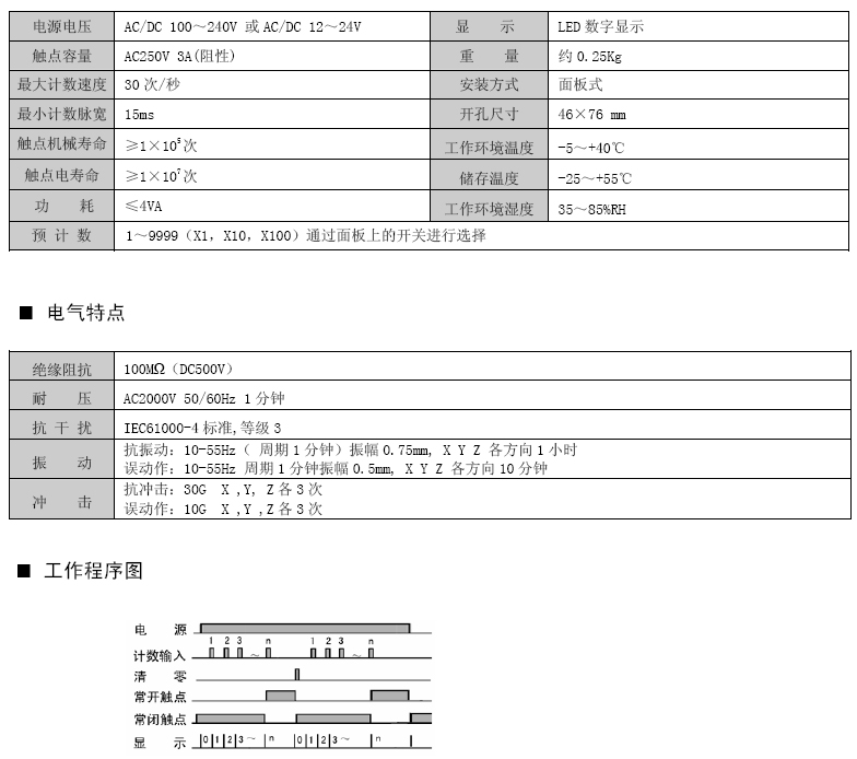

􀂄 ¼¼Êõ²ÎÊý
