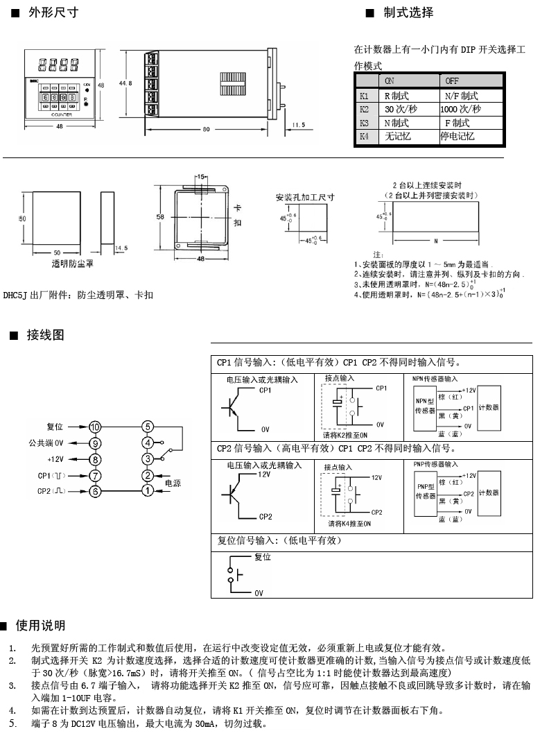

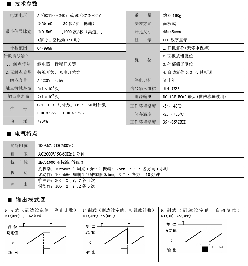

􀂄 ÌØµã
􀁺 ¹¦ÄÜÆëÈ«µÄСÐÍÔ¤ÖüÆÊýÆ÷£¬DIN ±ê×¼Ãæ°å³ß´ç£¨48¡Á48mm£©
􀁺 ¿ÉʵÏÖ×Ô¶¯¸´Î»¹¦ÄÜ(ʱ¼ä¿Éµ÷½Ú)
􀁺 ×î¸ß¼ÆÊýËÙ¶È1000 ´Î/Ãë
􀁺 ÄÚÖÃEEPROM Í£µç¼ÇÒä¿É´ïÊ®Äê
􀁺 DC12V,30mA ¸¨ÖúµçÔ´Êä³ö,¿É¹©Íâ½Ó´«¸ÐÆ÷ʹÓÃ
􀁺 ¿ÉÖ±½ÓÓë¹âµç¿ª¹Ø,½Ó½ü¿ª¹Ø»ò½ÓµãÐźŵÈÁ¬½Ó
􀁺 ·ûºÏµÄ±ê×¼:Q/WDH02-2003¡¢GB14048.5-2001¡¢IEC60947-5-1£º1997
