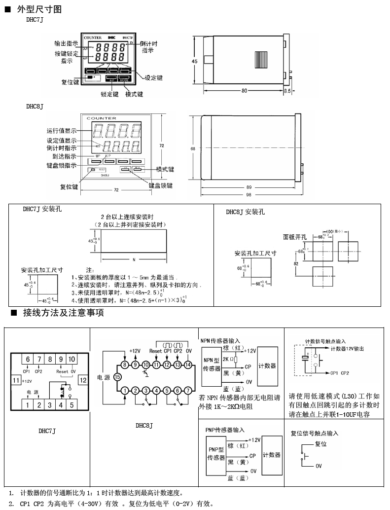

1048698; DIN 48¡Á48 mm¡¢72¡Á72 mm ±ê×¼Ãæ°å³ß´ç
1048698; ¹¦ÄÜÆëÈ«£¬²Ù×÷¼ò±ã £¬¸ßÐԼ۱ȡ£

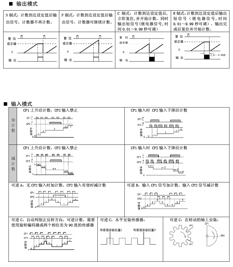

1048698; ¶àÖÖÊäÈ룬Êä³öģʽ¡£
1048698; Ö±Á÷12V 50mA µÄ¸¨ÖúµçÔ´Êä³ö£¬Ê¹Á¬½Ó´«¸ÐÆ÷¼«Îª·½±ã¡£
1048698; ¼üÅÌËø¶¨¹¦ÄÜ£¬·ÀÖ¹Îó²Ù×÷¡£
1048698; Í£µç¼ÇÒ䣬×Ô¶¯¸´Î»Ê±¼ä0.01¡«9.99 ÃëÊý×ÖÉ趨

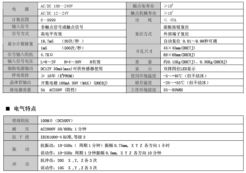

1048698; ·ûºÏµÄ±ê×¼:Q/WDH02-2003¡¢GB14048.5-2001¡¢IEC60947-5-1£º1997
1048708;
²úÆ·ÐͺÅ˵Ã÷
DHC7J Ãæ°å³ß´ç48¡Á48mm
DHC8J Ãæ°å³ß´ç72¡Á72mm
1048708;
¼¼Êõ²ÎÊý
