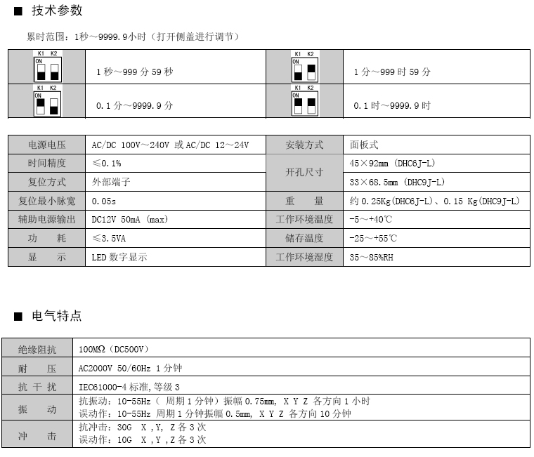

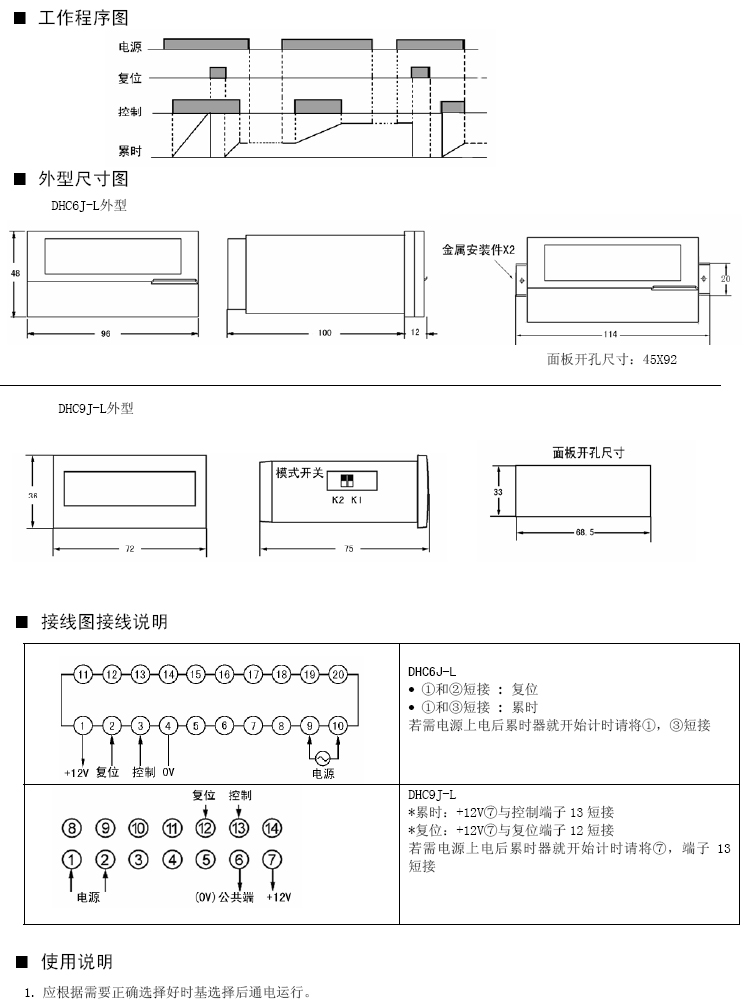

􀂄 ÌØµã
􀁺 DIN ±ê×¼Ãæ°å³ß´ç£¨48¡Á96 mm £©£¨36¡Á72 mm£©
􀁺 5 루 0.56 Ó¢´ç£©LED Êý×ÖÏÔʾ£¬²¢ÓÐÃëµãÉÁ˸
􀁺 ÀÛʱ·¶Î§1 Ãë¡«9999.9 Сʱ
􀁺 ²ÉÓÃE2PROM ±£³ÖÊý¾Ý£¬Êý¾Ý±£³Ö´ïÊ®Äê
􀁺 ¿ÉÑ¡Ôñ²»Í¬Ê±»ù
􀁺 ·ûºÏµÄ±ê×¼:
   Q/WDH 02-2003¡¢GB 14048.5-2001¡¢IEC60947-5-1£º1997
􀂄 ÐͺÅ˵Ã÷
   DHC6J-L Ãæ°å³ß´ç 48¡Á96 mm
   DHC9J-L Ãæ°å³ß´ç 36¡Á72 mm
