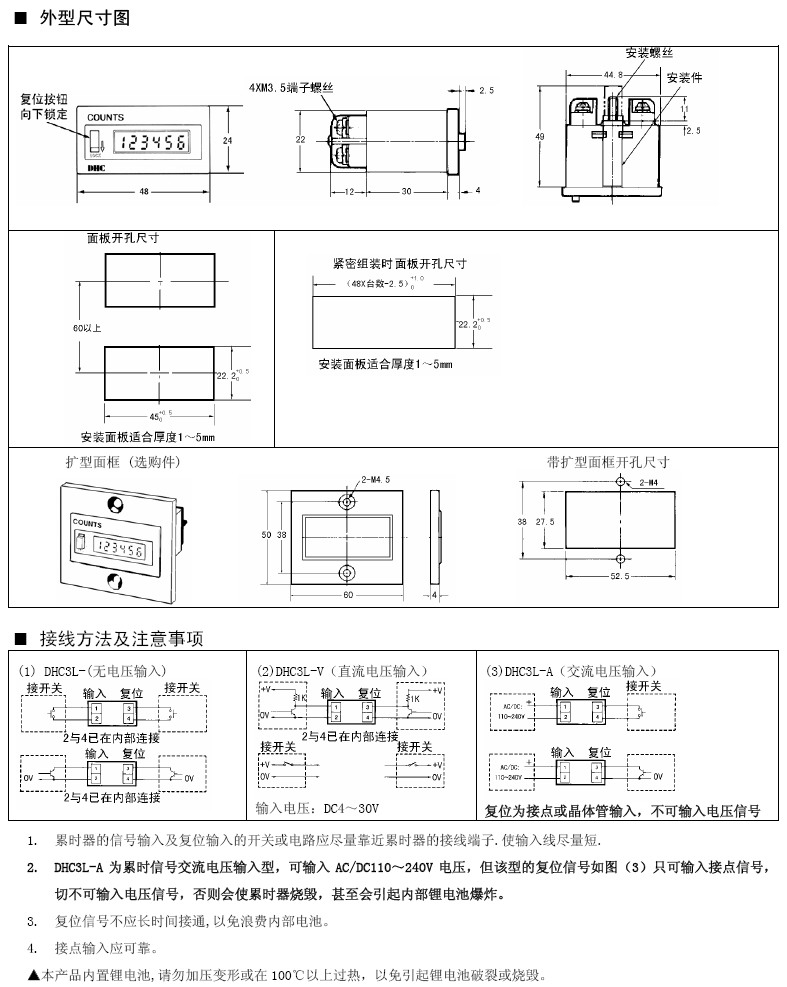

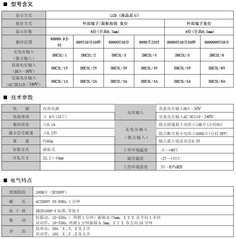

􀂄 ÌØµã
􀁺 ×îͨÓõÄÁ®¼ÛÀÛʱÆ÷
􀁺 DIN 48¡Á24mm ±ê×¼Ãæ°å³ß´ç£¬¿ÉÀ©Õ¹³É50¡Á60mm
􀁺 ÄÚ²¿×Ô´øµçÔ´£¬²»ÐèÍâ½Ó£¬ÄÚÖÃï®µç³Ø
􀁺 ÓÐÎÞµçѹÊäÈë¡¢Ö±Á÷µçѹÊäÈë¼°½»Á÷µçѹÊäÈëÐÍ
􀁺 6 λ»ò8 λLCD ÏÔʾ
􀁺 ÎÞ»úеĥËð£¬ÊÙÃü³¤
􀁺 ·ûºÏµÄ±ê×¼£ºQ/WDH 02-2003¡¢GB14048.5-2001¡¢IEC60947-5-1:1997
