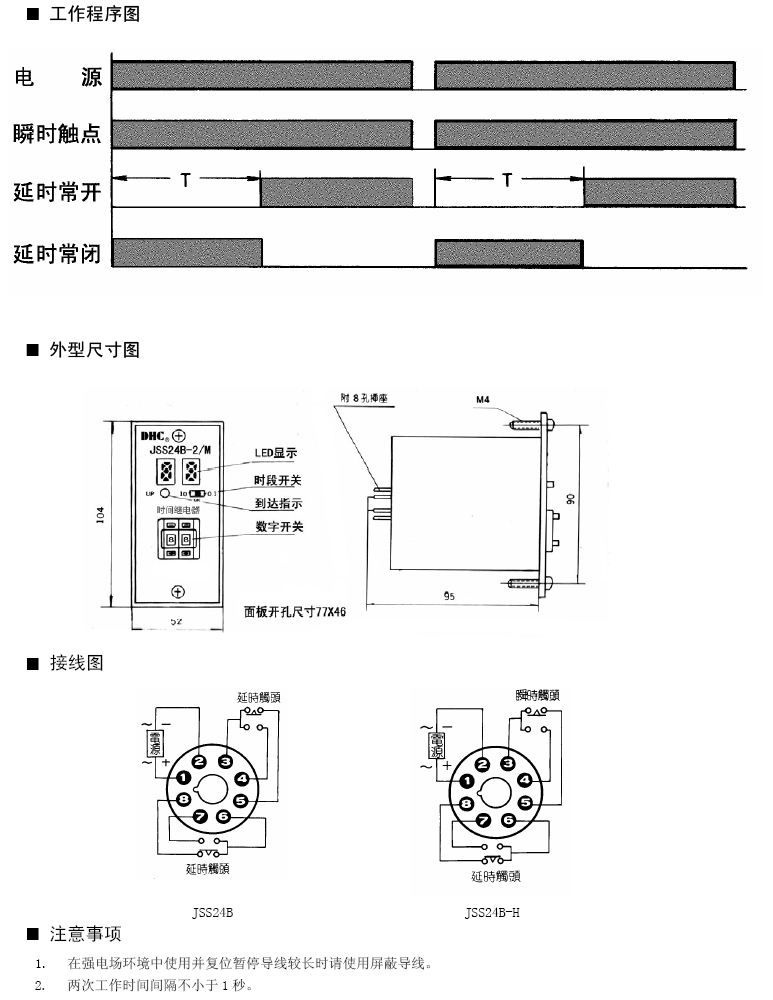

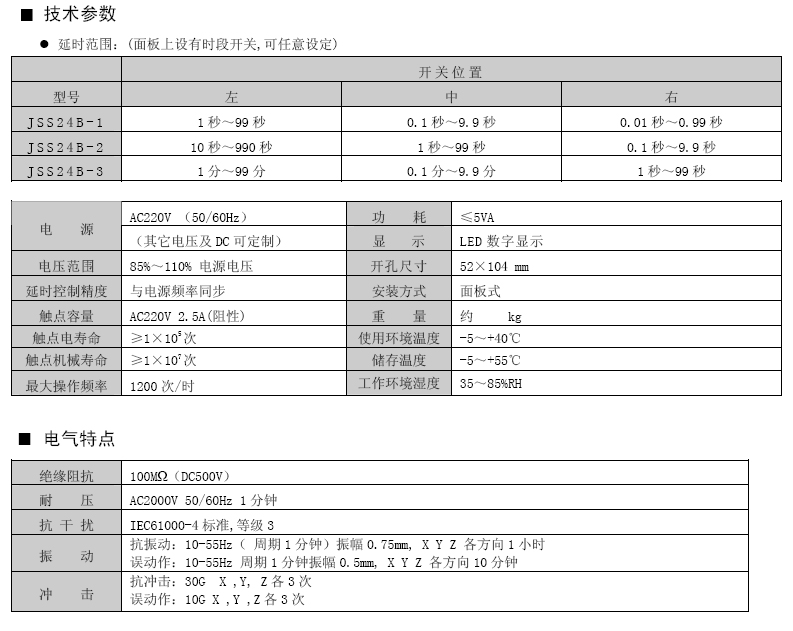

²úÆ·ÏêϸÐÅÏ¢£º
􀂄 ÌØµã
􀁺 JS14P,JS20P µÈʱ¼ä¼ÌµçÆ÷µÄÊýÏÔ²úÆ·
􀁺 ÍâÐͳߴçºÍ½ÓÏßÓëÆäÏàͬ
􀁺 LED Êý×ÖÏÔʾ£¬Êý×Ö¿ª¹ØÉ趨
􀁺 ÏÔʾ´ó£¬¼Û¸ñµÍ
􀁺 ×îÊʺÏËÜ»ú£¬Ï𽺻úе¼°·ÄÖ¯»úÅäÌ×
􀁺 ·ûºÏµÄ±ê×¼:
   Q/WDH 01-2003¡¢GB 14048.5-2001¡¢ IEC60947-5-1£º1997
􀂄 ÐͺÅ˵Ã÷
   JSS24B ÑÓʱÁ½×éת»»
   JSS24B-H Ò»×éÑÓʱ´¥Í·£¬Ò»×é˲¶¯´¥Í·
