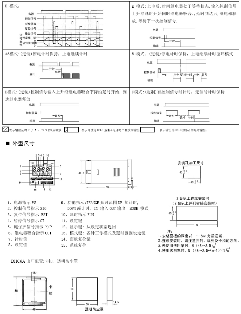

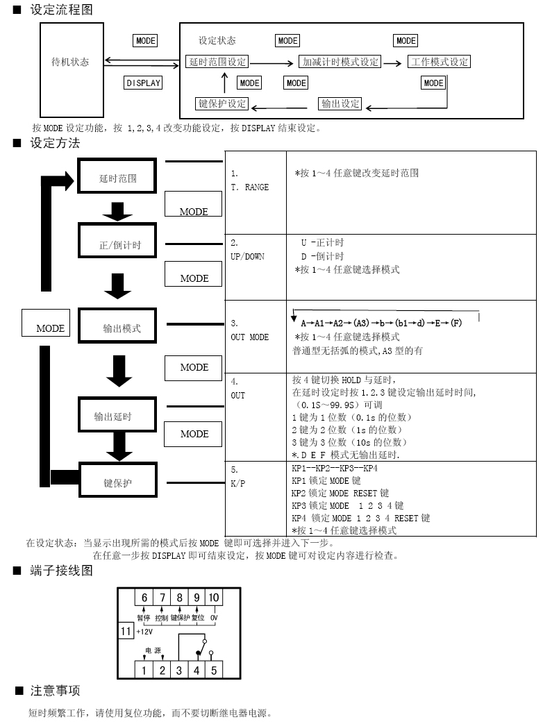

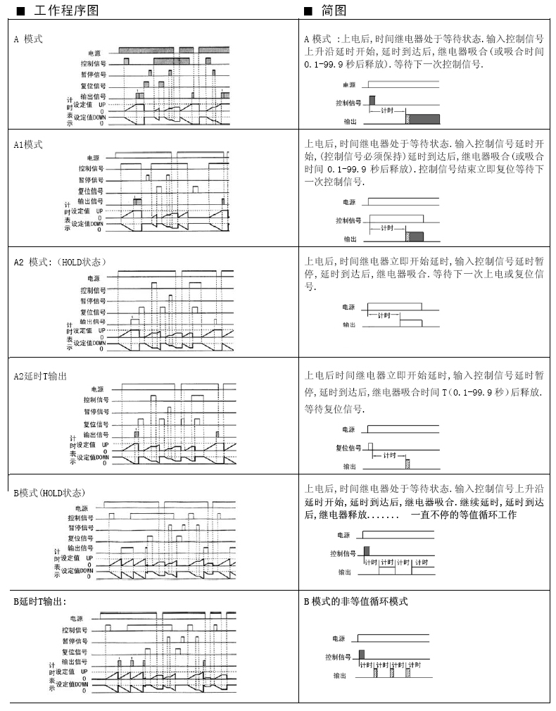

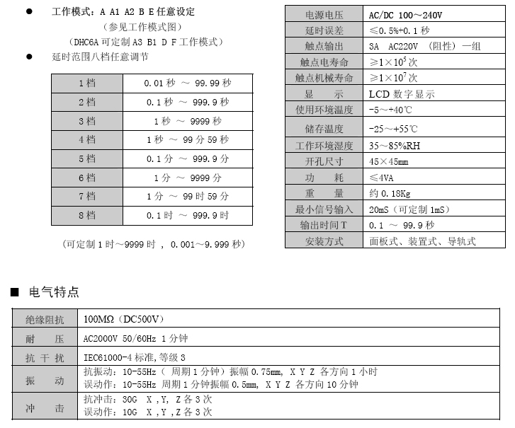

ÌØµã
1048698; DIN£¨48¡Á48mm£©±ê×¼Ãæ°å³ß´ç
1048698; 9 ÖÖ¹¤×÷ģʽ¿ÉÈÎÒâÉ趨£¬¼ò»¯ÍâΧÏß·,ÔöÇ¿¿É¿¿ÐÔ
1048698; ´ø±³¹âÔ´LCD ÏÔʾ£¬ÔÚÑô¹â»òºÚÒ¹¶¼ÄÜÇåÎúÏÔʾ
1048698; ¼ü±£»¤¿É°´ÒªÇóËø¶¨Ïà¹ØµÄ°´¼ü,±£»¤²¿·Ö»òÈ«²¿µÄÉ趨Êý¾Ý²»Êܸü
¸Ä£¬ÓÐЧµÄ·ÀÖ¹Îó²Ù×÷£¨DHC6A£©£¬²¢Ê¹Ê¹Óøü¼òµ¥
1048698; Í£µç±£³Ö²¢ÏÔʾÊý¾ÝÔ¼10 Äê
1048698; Õý¼ÆÊ±,µ¹¼ÆÊ±,ÑÓʱ·¶Î§´Ó0.01 Ãë¡«999.9 СʱÈÎÒâÉ趨
1048698; ¼ÌµçÆ÷Êä³öʱ¼ä¿Éµ÷(0.1¡«99.9 Ãë)¿É×÷Ë«É趨ʱ¼ä¼ÌµçÆ÷ʹÓÃ
1048698; ¸ß¾«¶È¡¢¸ß¿É¿¿ÐÔ
1048698; ·ûºÏµÄ±ê×¼: Q/WDH 01-2003¡¢GB 14048.5-2001¡¢IEC60947-5-1£º1997
1048708; ÐͺÅ˵Ã÷
DHC6A ͨÓüò»¯ÐÍ
DHC6A-A3 È«¹¦ÄÜÐÍ£¨°üÀ¨ËùÓй¦ÄÜ£©
