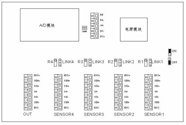

ÄÚ²¿½á¹¹

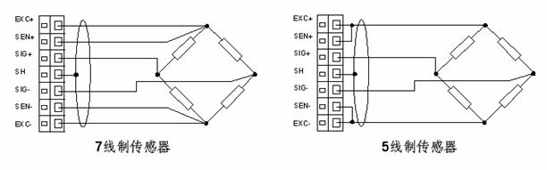

´«¸ÐÆ÷½Ó·¨
7ÏßÖÆºÍ5ÏßÖÆ´«¸ÐÆ÷·Ö±ð°´ÉÏͼ½ÓÏß¡£
DC+/DC-ΪֱÁ÷µçÔ´¶Ë×Ó£¬¿ÉÖ±½ÓÊäÈë18~36VÖ±Á÷µç£¬´ËʱLINK5¶Ï¿ª¡£
Èç¹û´«¸ÐÆ÷°²×°²»Æ½ºâµ¼ÖÂÐźŲîÒìºÜ´ó£¬¿É½«½ÓÏß¶Ë×ÓÉϲ¿µÄ¶Ì·¿é²åµ½ONλÖ㬵÷½ÚÅԱߵĵçλÆ÷¿Éʹ¸÷´«¸ÐÆ÷ÐÅºÅÆ½ºâ¡£
RA/RB¶Ë×ÓΪRS485ͨѶ½ÓÏß¶Ë×Ó¡£
