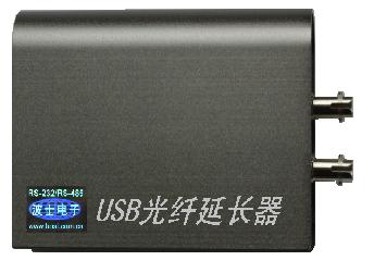

ͼ2£ºSTÍ·OPT-USB²úÆ·ÍâÐÎ

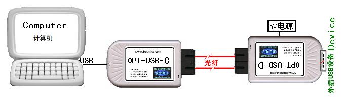

ÔÚͼ3ÖУ¬½«USBÉ豸Íâ²åµ½OPT-USB-DµÄUSB×ùÉÏ£¬OPT-USB-D½ÓÉÏ5VµçÔ´£¬ OPT-USB-DÓëOPT-USB-CÖ®¼äͨ¹ý2¸ù¹âÏ˽»²æÁ¬½Ó£¬OPT-USB-CÓë¼ÆËã»úµÄUSB¿ÚÏàÁ¬¡£Í¨¹ýÁ½Ì¨OPT-USB¹âÏËÑÓ³¤Æ÷£¨DÐÍÓëCÐÍÅä¶Ô£©¿ÉʵÏÖUSBÉ豸Óë¼ÆËã»úÖ®¼äµÄÔ¶³ÌUSB¹âÏËͨÐÅ¡£
ͼ3 OPT-USBµÄµäÐÍÓ¦ÓÃ
