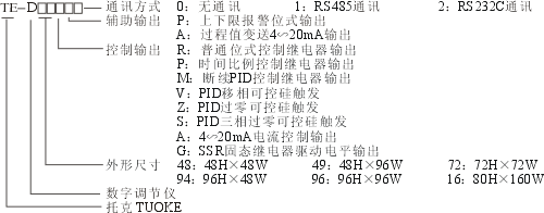

Ò»¡¢ Ðͺż°º¬Òå

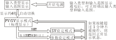

ËÄ¡¢²Ëµ¥²Ù×÷˵Ã÷
1¡¢¹¦ÄÜģʽÏÔʾ˳Ðò
2. ÊäÈëÄÚÐαí
