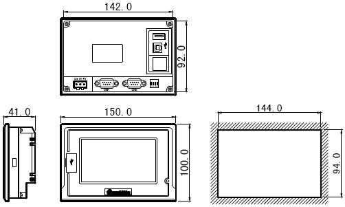

Íⲿ³ß´ç
150.0*100.0*41.0
Ãæ°å¿ª¿×³ß´ç
144.0*94.0
²úÆ·Íâ¹Û¼°³ß´ç(µ¥Î»:mm)
