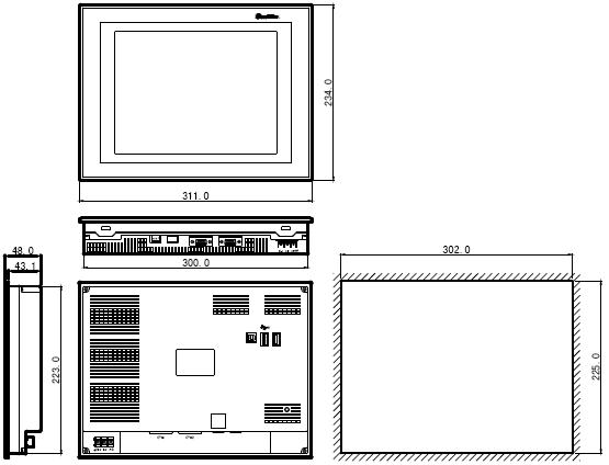

311.0*234.0*48.0
Ãæ°å¿ª¿×³ß´ç
302.0*225.0
²úÆ·Íâ¹Û¼°³ß´ç(µ¥Î»:mm)
