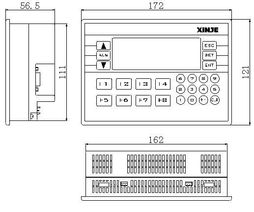

172*121*56.5
Ãæ°å¿ª¿×³ß´ç
164*113
²úÆ·ÍâÐμ°³ß´ç£¨µ¥Î»£ºmm£©
