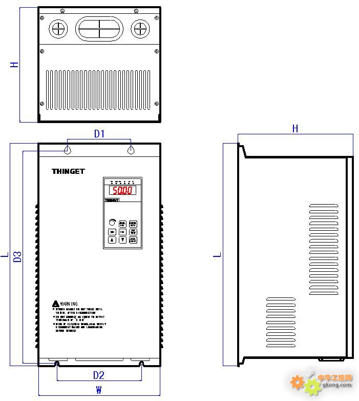

²úÆ·ÍâÐμ°³ß´ç£¨µ¥Î»£ºmm£©
²úÆ·ÐͺÅ
W
D1
L
D2
H
D3
V5-4011
230
120
420
160
218
400
V5-4015
V5-4018
