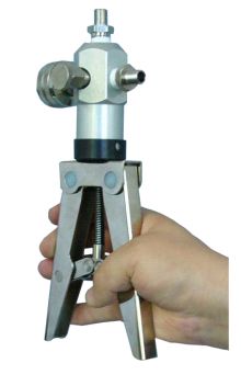

ÊÖ²ÙѹÁ¦±ÃÊÇÒ»ÖÖÒºÌåÐÍÊÖ²ÙѹÁ¦±Ã.ÓÃÓÚУÑ鹤ҵÁ÷³ÌÖÐÏÖ³¡Ð£Ñé°²×°µÄ²âÊÔÒDZíºÍ¿ØÖÆÊÒÄÚʹÓõĸ÷ÀàѹÁ¦ÒDZí.Ò²¿ÉΪ²âѹÒDZíÖÆÔ쳧У±íÌṩѹÁ¦Ô´.·²25MpaÒÔÄڵĸ÷ÀàѹÁ¦±äËÍÆ÷,ѹÁ¦´«¸ÐÆ÷ÒÔ¼°¸÷ÀàѹÁ¦ÒDZí¾ù¿ÉÓÃÊÖ²ÙѹÁ¦±Ã½øÐÐУÑé.
ÌØµã:
ÊÖ²ÙѹÁ¦±ÃΪ±ãЯʽ,ÖØÁ¿Çá,´òѹÇáÇÉ.ʹÓ÷½±ã.½á¹¹ÉÏÉè¼ÆÑ¹Á¦Î¢µ÷ÊÖ°Ñ,Ðýת΢µ÷Êְѿɷ½±ãµØ¸Ä±äÊä³öѹÁ¦.´ËÍ⻹¸½ÓиßѹÈí¹ÜÁ¬½Ó±»Ð£±í,ÒDZí½ÓÍ·Á¬½ÓѹÁ¦±í.ÊÖ²ÙѹÁ¦±Ã¿ÉËæÉíЯ´øµ½ÏÖ³¡Ö±½ÓÓ뱻УÒDZíÁ¬½Ó,УÑé¼ÈѸËÙÓÖ¼ò±ã
½á¹¹Ó빤×÷Ô­Àí
ÊÖ²ÙѹÁ¦±ÃÊÇÓÐÊÖ±ú,»îÈû¸Ë.Í¸ÆøÌå,±Ã¸Ç,·ÅÓÍÊÖ°Ñ,΢µ÷ÊÖ°Ñ,±í½ÓÍ·µÈ×é³É.Ðýת·ÅÓÍÊְѹرշÅÓÍ·§,ÊÖÎÕÊÖ²ÙѹÁ¦±ÃÊÖ±ú,ÓÃÁ¦ÎÕ½ô,·ÅËÉ·´¸´½øÐÐ,´Ó¶ø´ø¶¯»îÈû¸ËÍù¸´Ô˶¯,»îÈû¸ËÍù¸´Ô˶¯¼¸´Î¾Í¿ÉÒÔ²úÉúÊä³öѹÁ¦25Mpa.

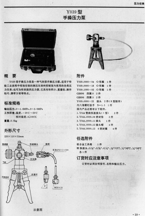

¼¼ÊõÊý¾Ý:
Êä³öѹÁ¦:0~25Mpa
¹¤×÷»·¾³:
a:ζÈ:0~40¡æ b:Ïà¶Ôʪ¶È:¡Ü100%
ÖØÁ¿:¡Ü0.8Kg
±í½ÓÍ·ÂÝÎÆ:M14¡Á1.5ÄÚÂÝÎÆ(³ö¿Ú°´1/4NPT),¸ßѹÈí¹ÜµÄ½ÓÍ·ÂÝÎÆ:M20¡Á1.5ÄÚÂÝÎÆ(³ö¿Ú°´1/2NPT)
ʹÓÃ×¢ÒâÊÂÏî
ѹÁ¦±ÃʹÓÃǰš½ôÍ¸ÆøÌå,³äÈëÊʵ±ÓÍÒº(Èç1/2±äѹÆ÷ÓÍ),È»ºóÔÚÉϽôÍ¸ÆøÌå,·´¸´ÎÕ½ô,·ÅËÉÊÖ±ú,¸Ï³öÓ͸×Ä򵀮øÌå¼´¿ÉʹÓÃ.УÑé¹ý³ÌÖÐ×¢Òâ¸÷ÀàÁ¬½Ó´¦±£³ÖÃÜ·â,УÑéÍêºóÔÚ²ðжÒDZíǰҪÏÈÐýת·ÅÓÍÊÖ°Ñ´ò¿ª·ÅÓÍ·§,·ñÔòÒ×Ëð»µÒÇÆ÷ÒDZí.
