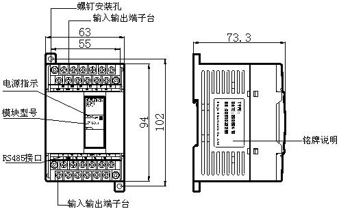

²úÆ·Íâ¹Û¼°³ß´ç£¨µ¥Î»£ºmm£©
³Ö×î¶à16¸öMAÄ£¿éÀ©Õ¹Á¬½Ó
