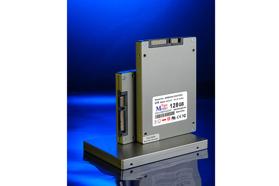

²úÆ·Ãû³Æ£º MemoRight rSSD
ÐÍ ºÅ£º MRS020A032GTS25I
Æ· ÅÆ£º 7411
 MemoRight rSSD
 1 ½Ó¿Ú¹æ·¶£ºSATA II 2 ÈÝÁ¿×î´ó¿É×öµ½128G 3 Í»·¢´«ÊäËÙ¶È 133 MB/sec 4 Á¬Ðø¶ÁËÙ¶È 120MB/sec 5 Á¬ÐøÐ´ËÙ¶È 120 MB/sec 6 I/OÐÔÄÜËæ»ú¶Á/дIOPS >6000/350(4KBÎļþ¿é) 7 ÑÓ³Ùʱ¼ä ÉÙÓÚ0.1 ms 8 ƽ¾ù¹ÊÕÏʱ¼ä 1,100,000hours...
       ¹¦ÄÜÌØÉ«£º
¡¤Êý¾ÝÍêÕûÐÔ - ¶ÀÌØµÄ¡°In-drive UPSÉè¼ÆÈ·±£ÔÚÈκζϵçÇé¿öÏÂÊý¾ÝµÄ¾ø¶ÔÍêÕûÐÔ£¬ÎÞ¶ªÊ§
¡¤°²È«ÐÔ - Ö§³ÖÊý¾Ý°²È«Ïú»Ù¹¦ÄÜ
¡¤ºãËÙ - ºã¶¨µÄ¶ÁдËٶȶԴóÅúÁ¿ÈÎÎñÐèÒª´¦ÀíµÄÓ¦ÓÃÊǺܹؼüºÜÖØÒªµÄ
¡¤Î¶Ƞ- ¿íδÓ-40C~+85C
¡¤¼Ó¹Ì - ·ûºÏÃÀ¾ü±ê"MIL-STD-810F"
¡¤ÈÝÁ¿ - 2.5¡± µ½128GB
¼¼Êõ¹æ¸ñ£º
MemoRight ²úÆ·ÐͺŠMRS020A032GTS25I MRS020A064GTS25I MRS020A128GTS25I
δ¸ñʽ»¯ÈÝÁ¿ 32GB 64GB 128GB
½éÖÊ (NAND Flash Memory Type) SLC SLC SLC
³ß´ç / »·¾³µÈ¼¶ 2.5 inch / Industrial
Interface (Gb/sec) SATA 2.0 (3.0Gb/sec)
ÐÔÄÜ
ÏìӦʱ¼ä <0.1ms <0.1ms <0.1ms
Á¬Ðø¶ÁËÙ¶È (MB/sec) >120 >120 >100
Á¬ÐøÐ´ËÙ¶È(MB/sec) >120 >120 >100
Ëæ»ú IOPS @4KB - ¶Á >6,000 >6,000 >5,300
Ëæ»ú IOPS @4KB - д >350 >350 >340
¿É¿¿ÐÔ / Ä;öÈ
Wear- Leveling Algorithm Dynamic, static and active (initiative)
»µ¿é±£Áô ÓÐ
S.M.A.R.T. ¼æÈÝÐÔ Ö§³Ö
дÈëÄ;ÃÐÔ, 1TB/Ìì (Äê) >5 >10 >20
¶ÁÈ¡Ä;ÃÐÔ ÎÞÏÞ ÎÞÏÞ ÎÞÏÞ
Êý¾Ý±£´æÊ±¼ä (years) 10 Äê £¨³£ÎÂÏ£©
MTBF (hours) >1,100,000 >1,100,000 >1,100,000
Êý¾ÝÍêÕûÐÔ
·ÇÕý³£µôµç×ÊÁ϶ªÊ§ ²»¶ªÊ§ (in-drive UPS)
²»¿É»Ö¸´¶Á´íÎó /Bits ¶Á <10-14 <10-14 <10-14
ECC (bits/528 Byte) 4 4 4
µçÔ´
ÊäÈëµçѹ 5V +/-5%
Æô¶¯¹¦ºÄ (ÍßÌØ) 3.75
¶Á / д¹¦ºÄ (watts) 2.0 / 2.0
¿ÕÏÐ/´ý»ú (watts) 1.0/1.0
ʹÓû·¾³ (¹¤Òµ¼¶)
¹¤×÷ÎÂ¶È (¡ãC) -40¡æ~85¡æ
´æ´¢ÎÂ¶È (¡ãC) -55¡æ~95¡æ
¹¤×÷º£°Î (feet) -1,000~80,000
¹¤×÷ʪ¶È 5%,95% (non-condensing)
ÔëÒô (bels. Typical) 0
ÎïÀí³ß´ç
³¤ (in/mm) 3.96 / 100.5
¿í (in/mm) 2.75 / 69.85
¸ß (in/mm) 0.374 / 9.5
ÖØÁ¿ (grams) 78.0¡À5.0 88.0¡À5.0
°²¹æÈÏÖ¤
FCC, CE, RoHS, UL/CUL
ÖÊÁ¿±£Ö¤
5Äê (ǰ3ÄêÃâ·Ñ£¬ºó2ÄêÊÕÈ¡Áã¼þ³É±¾ºÍÈ˹¤³É±¾)
