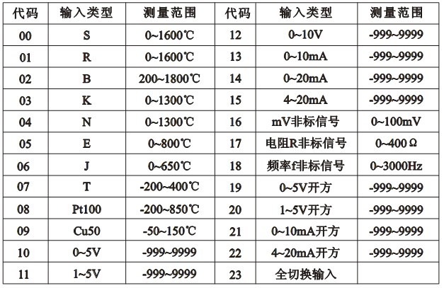

ÊäÈëÐźŠµç×衪¡ª¸÷ÖÖ¹æ¸ñÈȵç×裨¼û¹æ¸ñƪ£©£¬ÈçPt100¡¢Cu100¡¢
Cu50µÈ»òÔ¶´«Ñ¹Á¦µç×è
µçż¡ª¡ª¸÷ÖÖ¹æ¸ñÈȵçż£¨¼û¹æ¸ñƪ£©£¬ÈçB¡¢S¡¢K¡¢E¡¢J¡¢
T¡¢WReµÈ
µçѹ¡ª¡ª0~5V¡¢1~5V»òmVµÈ
µçÁ÷¡ª¡ª0~10mA¡¢4~20mA»ò0~20mAµÈ

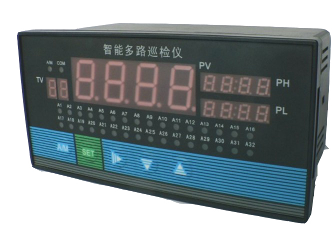

FWP-M D806¡¢807¡¢809¡¢814ϵÁУ¨ºáʽ£© S806¡¢807¡¢809¡¢814ϵÁУ¨Êúʽ£©
ÒDZíÍâÐÎ
ÍâÐÎ³ß´ç ¿í¡Á¸ß¡ÁÉ160¡Á80¡Á140mm ¿í¡Á¸ß¡ÁÉ80¡Á160¡Á140mm
¿ª¿×³ß´ç   µ¥Î»£ºmm   µ¥Î»£ºmm
ÖØÁ¿ ¡¤³£¹æÐÍ£º700g                              ¡¤ÌØÊâÐÍ£º500g

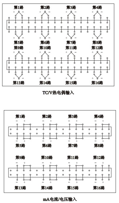

½ÓÏßͼ
±¸×¢ ÌØÊâ¶©»õÓë±¾½ÓÏßͼ²»Í¬Ö®´¦£¬ÒÔËæ»ú½ÓÏßͼΪ׼¡£(ÊúʽÓëÉϽÓÏßͼһÖ£¬µ«·½Ïò²»Ò»Ñù£¬ÊúʽÒDZíÏò×óÄæÊ±ÕëÐýת90¡æ¡£)²»Í¬¹¦ÄÜÔÚͬһ¶Ë×ӵģ¬Ö»ÄÜÑ¡ÆäÖÐÒ»ÖÖ¹¦ÄÜ¡£

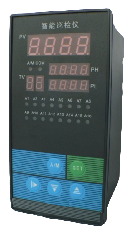

FWP-M D808ϵÁУ¨ºáʽ£© S808ϵÁУ¨Êúʽ£©
ÒDZíÍâÐÎ

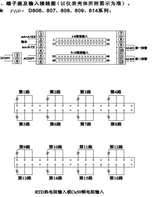

½ÓÏßͼ

´úÂë 06 07 08 09 14
¿ØÖÆ×÷Óà °Ë·Ѳ¼ì
²âÁ¿ÏÔʾ
°Ë·Ѳ¼ì
ͳһ±¨¾¯Êä³ö
°Ë·Ѳ¼ì
·Ö±ð±¨¾¯Êä³ö
Ê®Áù·
Ѳ¼ì²âÁ¿ÏÔʾ
Ê®Áù·Ѳ¼ì
ͳһ±¨¾¯Êä³ö
ͨѶ´úÂë
´úÂë 0 2 8 3
¿ØÖÆ×÷Óà ÎÞͨѶ RS-232ͨѶ½Ó¿Ú RS-485ͨѶ½Ó¿Ú RS-232´òÓ¡¿Ú
Êä³ö´úÂë
´úÂë 0 1 2 3 4 5 8
Êä³ö·½Ê½ ÎÞÊä³ö ¼ÌµçÆ÷ 4¡«20mA 0¡«10mA 1¡«5V 0¡«5V ÌØÊâ¹æ¸ñ
±¨¾¯´úÂë
´úÂë N H L
±¨¾¯·½Ê½ ÎÞλʽ±¨¾¯£¨¿ÉÊ¡ÂÔ£© λʽÉÏÏÞ±¨¾¯ λʽÏÂÏÞ±¨¾¯
ÊäÈë´úÂë
