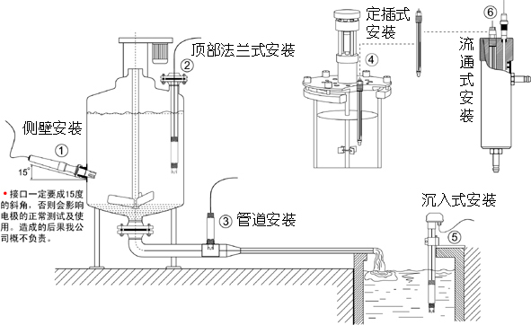

°²×°Ê¾Òâͼ
£¨ 1£©. ²à±Ú°²×°   £¨2 £© . ¶¥²¿·¨À¼Ê½°²×°£¨ 3£©. ¹ÜµÀ°²×°
£¨ 4£©. ¶¥²åʽ°²×° £¨5 £©. ³ÁÈëʽ°²×°     £¨6 £©. Á÷ͨʽ°²×°
