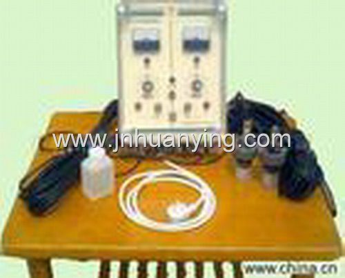

²úÆ·Ãû³Æ£º HY-100˫ͨµÀ©Âȱ¨¾¯ÒÇ
ÐÍ ºÅ£º HY-100
Ò»¡¢²úÆ·ÓÃ;¼°Ê¹Ó÷¶Î§:
  ©Âȱ¨¾¯ÒÇÊDzÉÓÃÃÀ¹úͬÀàÒÇÆ÷Ô­Àí£¬½áºÏ¹úÄÚʹÓÃÇé¿ö¶øÉè¼Æ£¬ÊÇÓÃÂȵ¥Î»ÓÃÀ´¼à²â¿ÕÆøÖÐÂÈÆøÅ¨¶È£¬È·±£ÈËÔ±°²È«¼°É豸°²È«µÄ±Ø±¸ÒÇÆ÷¡£µ±ÂÈÆøÐ¹Â©µ½¿ÕÆøÖеÄŨ¶È³¬¹ýÒÇÆ÷±¨¾¯É趨ֵʱ£¬ÒÇÆ÷½«×Ô¶¯±¨¾¯²¢Êä³ö¿ØÖÆÐźţ¬Æô¶¯°²È«±£»¤É豸£¬¸ÄÉÆÏÖ³¡»·¾³¡£
©Âȱ¨¾¯ÒÇÊÊÓÃÓÚ×ÔÀ´Ë®³§£¬Ò½ÔºÎÛË®´¦ÀíÕ¾£¬ÂÈÆøÉú²ú³§£¬¹¤ÒµÑ­»·Ë®´¦ÀíµÈÏÖ³¡ÓÃÂȼ°´¢ÂȲ¿ÃÅ¡£
¶þ¡¢Ö÷Òª¼¼ÊõÖ¸±ê£º
£¨1£©±¨¾¯·¶Î§£º1-5PPM£¨Ìå»ý±È£¬·Ö5¼¶É趨£©
£¨2£©ÏìӦʱ¼ä£º<30Ãë
£¨3£©»Ö¸´Ê±¼ä£º<5·ÖÖÓ
£¨4£©Êä³ö¼ÌµçÆ÷´¥µãÈÝÁ¿£º¡«220V3A
£¨5£©¹¤×÷µçÔ´£º¡«220V   50HZ
£¨6£©ÏûºÄ¹¦ÂÊ£º10W
£¨7£©¹¤×÷»·¾³£ºÎ¶ȣº5¡æ¡«40¡æ
              ζȣº£¼90%
Èý¡¢¹¤×÷Ô­Àí£º
   ÂÈÆø´«¸ÐÆ÷Êä³öµçÁ÷ÖµÓë»·¾³ÖÐÂÈÆøÅ¨¶È³ÉÕý±È¡£ÎÞÂÈÆøÊ±£¬´«¸ÐÆ÷Éϵĵç½âÒºÔڵ缫µç³¡µÄ×÷ÓÃÏ£¬µç¼«²úÉú¼«»¯£¬¶þµç¼«¼äµçÁ÷×îС¡£µ±ÓÐÂÈÆøÐ¹Â©²¢À©É¢µ½´«¸ÐÆ÷µÄµç¼«Ê±£¬µç¼«±»È¥¼«»¯£¬¼«¼äµçÁ÷Ôö´ó£¬µçÁ÷ÖµÓëÂÈÆøÅ¨¶È³ÉÕý±È£¬´«¸ÐÆ÷Êä³öµçÁ÷¾­ICV±ä»»Æ÷´¥·¢RCS¿ØÖƵç·±¨¾¯¡£
¸ÃÒÇÆ÷²ÉÓÃ˫·²âÊÔ£¬¶þ´«¸ÐÆ÷¿É·ÅÔÚ²»Í¬Î»Öã¬ËäÈ»¶þ´«¸ÐÆ÷Êä³öÐźŶÀÁ¢£¬µ«ÊÇÖ»ÒªÓÐһ·´«¸ÐÆ÷̽²âµ½ÂÈÆøÅ¨¶È³¬¹ýÉ趨ֵʱ£¬Êä³ö¼´¿ÉÆô¶¯¡£
ËÄ¡¢ÒÇÆ÷²Ù×÷·½·¨£º
 1Ãæ°å½éÉÜ£º
   1¡¢±¨¾¯Ö¸Ê¾µÆ
   2¡¢±¨¾¯É趨ÐýŦ
   3¡¢¸´Î»°´Å¦
   4¡¢µ÷Áã
   5¡¢µçÔ´¿ª¹Ø
   6¡¢µ÷Áã
   7¡¢¸´Î»°´Å¦
   8¡¢±¨¾¯É趨ÐýŦ
   9¡¢±¨¾¯Ö¸Ê¾µÆ
2¡¢´«¸ÐÆ÷½éÉÜ£º
  ´«¸ÐÆ÷½éÉÜ£º
£¨1£©µç¼«Ð¾Öù
 £¨2£©·À³¾ÕÖ
 £¨3£©´¢ÒºÊÒ
3¡¢×¼±¸¹¤×÷£º
  £¨1£©³õ´ÎʹÓÃʱ£¬ÓÃë±Ê½«µç½âҺͿÔڵ缫ÍÑÖ¬²¼ÉÏ£¬Ê¹µç¼«¼ä³äÂúµç½âÒº¡£²¢°Ñ´¢ÒºÊÒ¼ÓÂúµç½âÒº£¬ÍÑÖ¬²¼½«×Ô¶¯ÎüÒº±£³Öµç¼«ÊªÈó¡£
  £¨2£©ÓÃÅäÖõÄÀÂÏß½«ÒÇÆ÷Óë´«¸ÐÆ÷Á¬½Ó£¬²¢½«´«¸ÐÆ÷¹Ì¶¨ÔÚ×îÒ׳öÏֵĩÂȲ¿Î»¡£
  £¨3£©°²×°´«¸ÐÆ÷²¿Î»Ó¦×¢Òâ·çÏò£¬±ÜÃâË®½¦£¬»Ò³¾¼°»úеËðÉË£¬Í¨³£°²×°ÔÚ¾àµØÃæÒ»Ã×ÒÔÏ¡£
  £¨4£©¶þ´ÎÒDZí²ÉÓñڹÒʽ»úÏ䣬Ӧ·ÅÔÚÎÞÇ¿´Å³¡£¬ÎÞ»úеÕ𶯣¬ÎÞ¸¯Ê´ÐÔ½éÖÊ»·¾³ÖС£
  £¨5£©±¨¾¯ÒÇÊä³ö²ÉÓÃÎÞÔ´¼ÌµçÆ÷£¨Ï൱¿ª¹Ø£©£¬¿ÉÓÉÓû§¸ù¾ÝÐèÒªÁ¬½Ó¡£
 £¨6£©½ÓͨµçÔ´¡£
4¡¢²Ù×÷·½·¨£º
 £¨1£©´ò¿ª"µçÔ´"¿ª¹Ø£¬µçԴָʾµÆÁÁ¡£
  ×¢Ò⣺´ò¿ªµçÔ´¿ª¹ØÊ±£¬ÒÇÆ÷ͨ³£»á±¨¾¯£¬´Ëʱ±¨¾¯Êǵ缫˲¼ä¼«»¯Ôì³ÉµÄÏÖÏó£¬Ö¸Õë°Ú¶¯ºóºÜ¿ì»ØÁ㣬ÊôÕý³£×´Ì¬¡£¿É°´¸´Î»°´Å¥»Ö¸´¡£
 £¨2£©×ª¶¯"¼à²âI"£¬"¼à²âII"·²¨¶Î¿ª¹ØÉ趨±¨¾¯Öµ£¬ÒÇÆ÷¿ªÊ¼½øÈëÕý³£×´Ì¬¡£
  ÒÇÆ÷³ö³§Ê±ÁãµãÒѵ÷ºÃ£¬Óû§µ÷Áãʱ¿ÕÆøÖв»µÃº¬ÓÐÂÈÆø¡£
 £¨3£©±¨¾¯Ê±Î¢°²±íָʾֵÓë¼à²âµãÂÈÆøÅ¨¶ÈÖµ¶ÔÓ¦ÈçÏ£º
      10¦ÌA£­£­1PPM
      20¦ÌA£­£­2PPM
      30¦ÌA£­£­3PPM
      40¦ÌA£­£­4PPM
      50¦ÌA£­£­5PPM
Îå¡¢´«¸ÐÆ÷µÄά»¤£º
   ´«¸ÐÆ÷ÊDZ¨¾¯µÄ¹Ø¼ü²¿¼þ£¬¸Ä½øºóµÄ´«¸ÐÆ÷²»Ð趨ÆÚÍùµç¼«ÉÏͿҺ£¬Ö»Òª´¢ÒºÊÒÄÚ×¢Âúµç½âÒºÄܳ¤ÆÚ±£³Öµç¼«ÊªÈó¡£
³¾ÍÁ½Ï¶à»òµç½âÒº¸ÉºÔʱ£¨´ËÏÖÏóÊÇ´ò¿ªµçԴ˲¼ä΢°²±íָʾֵºÜС£©¿ÉÓÃÎÞË®ÒÒ´¼ÇåÏ´£¬´ý¸ÉÔïºó¼ÌÐøÊ¹Óã¬ÇåϴʱӦÇжϵç·£¬Î𽫰׽ðË¿Åö¶Ï·»ò¶Ì·¡£
Áù¡¢ÒÇÆ÷ÅäÌ×±í£º
  £¨1£©Ö÷»úһ̨£¨Ë«Â·£©
     ÍâÐγߴç:280X220X125mm°²×°³ß´ç(ÈçÓÒͼ£©:
    (2)´«¸ÐÆ÷     2Ö§ ´øÖ§¼Ü
    (3)ÀÂÏß       2Ìõ?20M
    (4)µçÔ´Ïß     1Ìõ?2M(ÒÇÆ÷×Ô´ø)
    (5)Êä³ö²åÍ·   1Ö»
    (6)µç½âÒº     1Æ¿
    (7)ë±Ê       1Ö§
±¾»úÊÛ³öÖ®ÈÕÒ»ÄêÄÚ,ÈçÒòÖÆÔì²»Á¼Ôì³ÉÒÇÆ÷²»ÄÜÕý³£¹¤×÷,ÔòÃâ·ÑΪÓû§ÐÞÀí.
