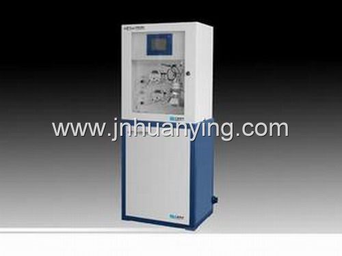

²úÆ·Ãû³Æ£º HY-ADϵÁÐÔÚÏß°±µª¼ì²âÒÇ
ÐÍ ºÅ£º HY-ADϵÁÐ
ÒÇÆ÷ÌØµã£º
²ÉÓô¥ÃþÆÁÏÔʾ£¬ÖÐÎIJÙ×÷½çÃæ£¬²Ù×÷·½±ã£¬Î¬»¤¹¤×÷Á¿ÉÙ¡£
¾ßÓÐ×Ô¶¯ºãοØÖÆ×°Öã¬Ê¹±»²âÒºÌåºãÎÂÔÚºÏÊʵÄζÈÏ¡£
¾ßÓиôÀëÊä³ö(4¡«20)mA DCÐźţ¬Æä¶ÔÓ¦°±Å¨¶ÈµÄÊä³öÉÏÏÞºÍÊä³öÏÂÏÞ¡£
¾ßÓпɵ÷ÉÏÏÂÏÞ±¨¾¯¡£
×Ô¶¯¿ØÖƲâÁ¿¡¢±ê¶¨¡¢ÇåÏ´µÈ¹ý³Ì¡£
²ÉÑù±Ã²ÉÑùÖÜÆÚ¿ÉÈÎÒâÉèÖÃ(¿É¿ØÈýÏîµçÔ´)
¾ßÓÐRS-232»òRS-485½Ó¿Ú¡£
Ó¦Ó÷¶Î§£º
DWG£­8002AÐͰ±µª×Ô¶¯¼à²âÒÇ¿ÉÓÃÓÚ¼à²â½­ºÓºþË®¡¢µØ±íË®¡¢×ÔÀ´Ë®³§¡¢ÎÛË®´¦Àí³§¡¢ÆóÒµ·ÏË®ÅŷŵÄË®ÌåÖа±Å¨¶È¼à²â
(1)²âÁ¿·¶Î§£º0.05mg/L¡«1000mg/L¡£
(2)¼ä¶Ï²âÁ¿¼ä¸ôʱ¼ä£º1h¡«12h
(3)²âÁ¿¾«¶È£º¡À10%
(4)ÖØ¸´ÐÔ£ºÏà¶Ô±ê׼ƫ²î²»´óÓÚ3%
(5)Îȶ¨ÐÔ£º¡Ü10%4h
(6)ÏìӦʱ¼ä(T90)£º£¼5min¡£
(7)ÐźÅÊä³ö£º¸ôÀ루4¡«20£©mA DC£¨×î´ó¸ºÔØ750?£©
(8) ²ÉÑù±ÃÒªÇ󣺣¨5¡«10£©m3/h£»£¨0.2¡«0.4£©bar
(9)ÍâÐγߴ磺600¡Á450¡Á1607mm(l¡Áb¡Áh)
(10)ÖØÁ¿£ºÔ¼50kg
