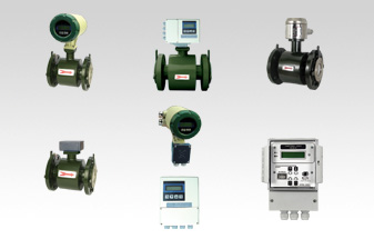

²úÆ·Ãû³Æ£º HY-LD-03µç´ÅÁ÷Á¿¼Æ
ÐÍ ºÅ£º HY-LD-03
²úÆ·½éÉÜ
¡¡µç¡¡´Å¡¡Á÷¡¡Á¿¡¡¼Æ
¡¡¡¡HY-LD-03µç´ÅÁ÷Á¿¼ÆÓÉ´«¸ÐÆ÷ºÍת»»Æ÷Á½²¿·Ö¹¹³É¡£ËüÊÇ»ùÓÚ·¨
À­µÚµç´Å¸ÐÓ¦¶¨Âɹ¤×÷µÄ£¬ÓÃÀ´²âÁ¿µçµ¼ÂÊ´óÓÚ5¦ÌS/cmµ¼µçÒº
ÌåµÄÌå»ýÁ÷Á¿£¬ÊÇÒ»ÖÖ²âÁ¿µ¼µç½éÖÊÌå»ýÁ÷Á¿µÄ¸ÐӦʽÒÇ±í¡£
³ý¿É²âÁ¿Ò»°ãµ¼µçÒºÌåµÄÌå»ýÁ÷Á¿Í⣬»¹¿ÉÓÃÓÚ²âÁ¿Ç¿Ëᡢǿ
¼îµÈÇ¿¸¯Ê´ÒºÌåºÍÄཬ¡¢¿ó½¬¡¢Ö½½¬µÈ¾ùÔȵÄÒº¹ÌÁ½ÏàÐü¸¡Òº
ÌåµÄÌå»ýÁ÷Á¿¡£¹ã·ºÓ¦ÓÃÓÚʯÓÍ¡¢»¯¹¤¡¢Ò±½ð¡¢Çá·Ä¡¢ÔìÖ½¡¢
»·±£¡¢Ê³Æ·µÈ¹¤Òµ²¿Ãż°ÊÐÕþ¹ÜÀí¡¢Ë®Àû½¨Éè¡¢ºÓÁ÷Êè¿£µÈ
ÁìÓòµÄÁ÷Á¿¼ÆÁ¿¡£

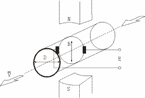

Ô­ÀíÓë½á¹¹
¸ù¾Ý·¨À­µÚµç´Å¸ÐÓ¦Ô­Àí£¬ÔÚÓë²âÁ¿¹ÜÖáÏߺʹÅÁ¦ÏßÏà´¹Ö±µÄ¹Ü±ÚÉϰ²×°ÁËÒ»¶Ô¼ì²âµç¼«£¬µ±µ¼µçÒºÌåÑØ²âÁ¿¹ÜÖáÏßÔ˶¯Ê±£¬µ¼µçÒºÌåÇиî´ÅÁ¦Ïß²úÉú¸ÐÓ¦µçÊÆ£¬´Ë¸ÐÓ¦µçÊÆÓÉÁ½¸ö¼ì²âµç¼«¼ì³ö£¬ÊýÖµ´óСÓëÁ÷Á¿³É±ÈÀý£¬ÆäֵΪ£º
ʽÖУºE=KBVD
E-¸ÐÓ¦µçÊÆ£»
K-Óë´Å³¡·Ö²¼¼°ÖáÏò³¤¶ÈÓйصÄϵÊý¡£
B-´Å¸ÐӦǿ¶È£»
V-µ¼µçÒºÌ寽¾ùÁ÷ËÙ£»
D-µç¼«¼ä¾à£»£¨²âÁ¿¹ÜÄÚÖ±¾¶£©
´«¸ÐÆ÷½«¸ÐÓ¦µçÊÆE×÷ΪÁ÷Á¿Ðźţ¬´«Ë͵½×ª»»Æ÷£¬¾­·Å´ó£¬±ä»»Â˲¨¼°Ò»ÏµÁеÄÊý×Ö´¦Àíºó£¬Óôø±³¹âµÄµãÕóʽҺ¾§ÏÔʾ˲ʱÁ÷Á¿ºÍÀÛ»ýÁ÷Á¿¡£×ª»»Æ÷ÓÐ4~20mAÊä³ö£¬±¨¾¯Êä³ö¼°ÆµÂÊÊä³ö£¬²¢ÉèÓÐRS-485µÈͨѶ½Ó¿Ú¡£
ÒDZíÌØµã
²âÁ¿¹ÜÄÚÎÞ×èÁ÷¼þ£¬Ñ¹Á¦ËðʧΪÁ㣬²»Ò×¶ÂÈû¡£
Ö»ÒªºÏÀíÑ¡Óõ缫¼°³ÄÀï²ÄÁÏ£¬¼´¿É´ïµ½Ä͸¯Ê´¡¢ÄÍÄ¥ËðµÄÒªÇó¡£
²âÁ¿½á¹ûÓëÒºÌåµÄѹÁ¦¡¢Î¶ȡ¢Ãܶȡ¢Õ³¶È¡¢µçµ¼ÂÊ£¨²»Ð¡ÓÚ×îµÍµçµ¼ÂÊ£©µÈÎïÀí²ÎÊý»ù±¾Î޹أ¬²»ÊÜ»·¾³Ó°Ï죬ËùÒÔ²âÁ¿¾«¶È¸ß¡¢¹¤×÷Îȶ¨¡¢¿É¿¿¡£
²ÉÓÃÏÖ´úÄ£ÄâÐźÅת»»¼¼ÊõºÍ¸ßÐÔÄܳ¬´ó¹æÄ£¼¯³ÉоƬ£¬¶ÔÐźŽøÐиôÀë¡¢Â˲¨¡¢·Å´ó¼°Êý×Ö´¦Àí¡£¾«È·ÏÔʾ²âÁ¿½á¹û¡£
¾ßÓвâÁ¿Öµ¶Ïµç±£»¤¼°¹ýÁ¿³Ì±¨¾¯¹¦ÄÜ£¬¿É¶Ô´«¸ÐÆ÷ÄÚÁ÷ÌåµÄÁ÷Ïò½øÐÐÉèÖã¬Òò¶ø´«¸ÐÆ÷°²×°²»ÊÜÒºÌåÁ÷¶¯·½ÏòÏÞÖÆ£¬¿ÉʵÏÖË«Ïò²âÁ÷¡£
²ÉÓôø±³¹âµãÕóʽ˫ÅÅÁ÷Á¿ÏÔʾÆ÷£¬Í¬Ê±ÏÔʾ˲ʱÁ÷Á¿¡¢ÀÛ»ýÁ÷Á¿£¬²¢ÄÜÏÔʾ¹¤×÷״̬¡¢²ÎÊý¡¢¼ÆÁ¿µ¥Î»µÈ¡£
µç´ÅÁ÷Á¿¼ÆµÄÁ¿³Ì·¶Î§¿í£¨×î´óÁ÷Á¿/×îСÁ÷Á¿£©£¬Õý³£ÊÊÓ÷¶Î§20£º1£¬Ò»°ã30£º1»ò¸ü´ó¡£
ÒDZíÅäÖÃÓжàÖÖÊä³ö¹¦ÄÜ¡¢¿ÉÓë¼ÆËã»ú¡¢µ¥Ôª×éºÏÒDZíÅäÌ×£¬¿ÉÍê³É´òÓ¡¡¢Í¨Ñ¶ºÍÁªÍøµÄÒªÇó¡£
