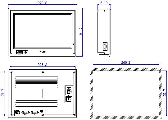

Íⲿ³ß´ç
272.2*191.7*51.2
Ãæ°å¿ª¿×³ß´ç
260.2*179.7
²úÆ·Íâ¹Û¼°³ß´ç(µ¥Î»:mm)
