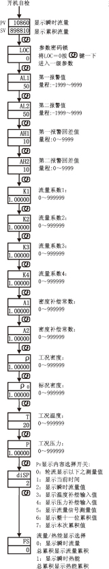

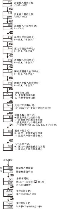

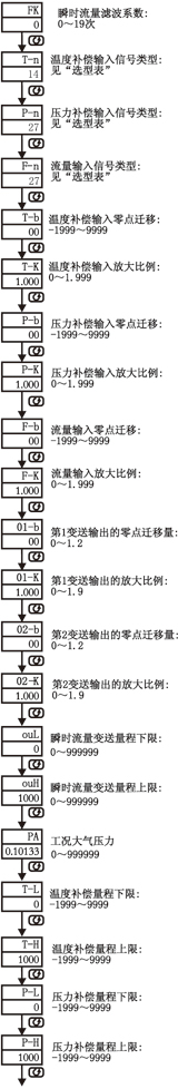

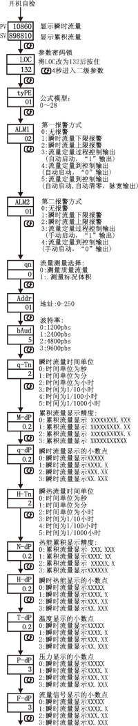

    ²ÎÊýÉ趨ÃÜÂëËø¶¨£¬²ÎÊýÉèÖöϵçÓÀ¾Ã±£´æ£¬¾ß±¸²ÎÊý»Ö¸´³ö³§É趨¹¦ÄÜ¡£

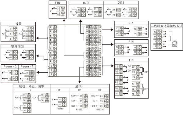

ÒDZí½ÓÏßͼ
    ¹æ¸ñ³ß´çΪA¡¢B¡¢CÐͽÓÏßͼ
    ×¢£ººáÊúʽÒDZíºó¸Ç½ÓÏß¶Ë×Ó·½Ïò²»Ò»Ñù£¬¼ûʾÒâͼ1¡£
