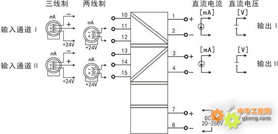

½ÓÏßͼ

ÊäÈë
ÊäÈëÐźŠֱÁ÷µçѹ¡¢µçÁ÷ÐźÅ(Óû§¿É¸ù¾ÝÐèÇóÈÎÒâÉèÖÃÊäÈëÀàÐÍ)
ÊäÈë×迹 µçÁ÷×迹≤50Ω£¬µçѹ×迹≥250KΩ
×î´óÊäÈëµçÁ÷/µçѹ ≤30mA/≤10.5V
Åäµçµçѹ/×î´óµçÁ÷ 19¡«25 V/≤25mA
Êä³ö
Êä³öÐźŠ4-20mA¡¢0-10mA¡¢0-20mA¡¢1-5V¡¢0-5V
Êä³ö¸ºÔØ 4-20mA¡¢0-10mA¡¢0-20mA ¸ºÔصç×èRL≤500Ω£»1-5V¡¢0-5V¸ºÔصç×èRL≥250KΩ
µçÔ´
µçÔ´ DC/AC20-260V (50/60Hz)
¹¦ºÄ Ò»½øÒ»³ö¹¦ºÄ£º≤1W£»Ò»½ø¶þ³ö¡¢¶þ½ø¶þ³ö¹¦ºÄ£º≤1.4W
ÆäËü²ÎÊý
¾øÔµµç×è
(ÊäÈë/Êä³ö/µçÔ´Ö®¼ä)
≥100MΩ£¨500VDCʱ£©
¾øÔµÇ¿¶È
1500Vrms (1 min£¬ÎÞ»ð»¨)
¹¤×÷ÎÂ¶È -10¡«50¡æ(ÎÞÄý¶¡¢ÎÞ½á±ù)
Ïà¶Ôʪ¶È 25%¡«85%RH
±£´æÎÂ¶È -10¡«60¡æ(ÎÞÄý¶¡¢ÎÞ½á±ù)
ÎÂ¶ÈÆ¯ÒÆ 0.0075%FS/¡æ
°²×°·½Ê½ 35mmDINµ¼¹ì°²×°
°²×°³ß´ç 17.5*111.4*121.2mm(¿í*¸ß*Éî)
´«Ê侫¶È£¨20¡æ£© 0.2%FS±1×Ö
ÏìӦʱ¼ä 50ms´ïµ½×îÖÕÖµµÄ90%
ÖØÁ¿ Ô¼140¿Ë
µç´Å¼æÈÝÐÔ ·ûºÏGB/T18268¹¤ÒµÉ豸ӦÓÃÒªÇó£¨IEC 61326-1£©
ÊÊÓÃÏÖ³¡É豸
¶þÏßÖÆ¡¢ÈýÏßÖÆ±äËÍÆ÷£¬Ö±Á÷µçѹ/µçÁ÷Ô´
ÒDZíÑ¡ÐÍ
±¸×¢£º
   µ±Êä³ö¢ñÑ¡ÔñRS485ͨѶʱ£¬ÎÞÊä³ö¢ò¹¦ÄÜ¡£
    ÐͺžÙÀý£ºNHR-X33-27/X-0/X-A
    µ¼¹ìʽÖÇÄÜÅäµçÆ÷£¬µÚһ·ÊäÈëÐźÅΪ4¡«20mA£¬µÚ¶þ·ÎÞÊäÈëÐźţ¬µÚһ·Êä³öÐźÅΪ4¡«20mA£¬µÚ¶þ·ÎÞÊä³ö£¬¹©µçµçԴΪDC/AC20¡«260V¡£
