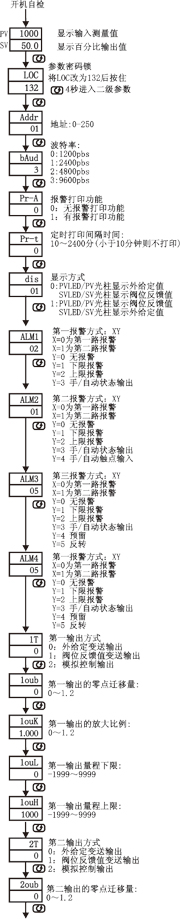

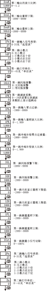

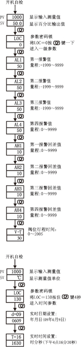

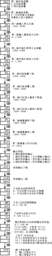

²ÎÊý¹¦ÄÜ
    ×¢£ºÒÔÉϲÎÊýΪÒDZíÈ«²¿²ÎÊý£¬Èç¹û²»ÊÇÈ«¹¦ÄÜÒÇ±í£¬Ôòδѡ¹¦ÄÜËù¶ÔÓ¦µÄ²ÎÊý½«²»ÓèÏÔʾ¡£

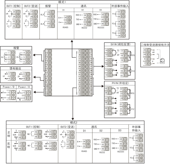

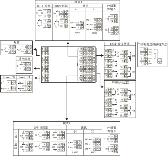

ÒDZí½ÓÏßͼ
    ¹æ¸ñ³ß´çΪA¡¢B¡¢C¡¢D¡¢E¡¢K¡¢LÐͽÓÏßͼ
    ×¢£ººáÊúʽÒDZíºó¸Ç½ÓÏß¶Ë×Ó·½Ïò²»Ò»Ñù£¬¼ûʾÒâͼ1¡£
ͼһ
¹æ¸ñ³ß´çΪFÐͽÓÏßͼ
    ×¢£ºÉÏÊö½ÓÏßͼÖÐÔÚͬһ×é¶Ë×Ó±êÓв»Í¬¹¦Äܵģ¬Ö»ÄÜÑ¡ÔñÆäÖÐÒ»ÖÖ¹¦ÄÜ¡£ÈçRS485ºÍRS232ÔÚͬһ×é½ÓÏß¶Ë×ÓÉÏ£¬Ö»ÄÜÑ¡ÔñÒ»ÖÖ¡£
